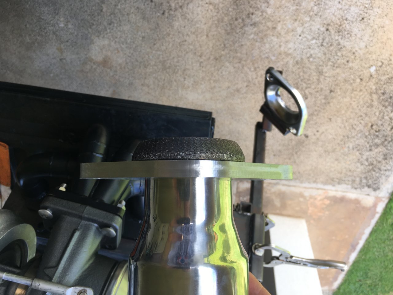

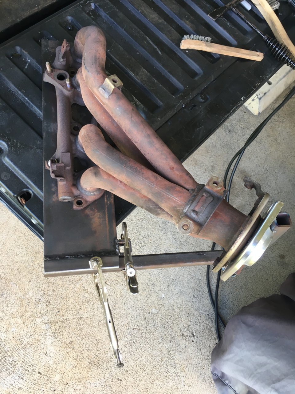

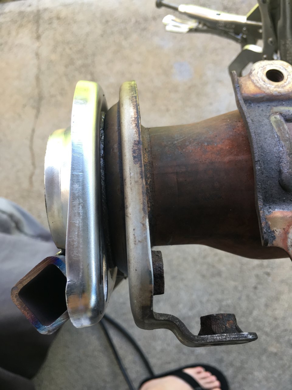

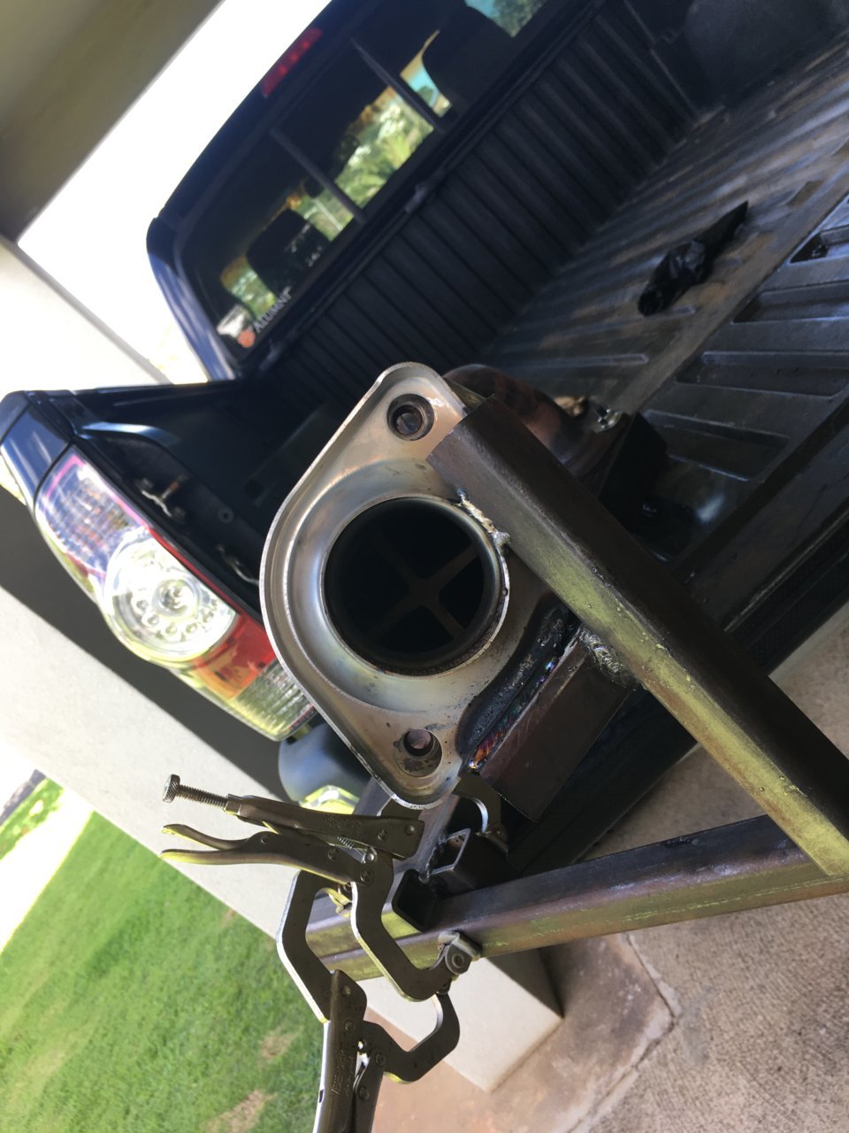

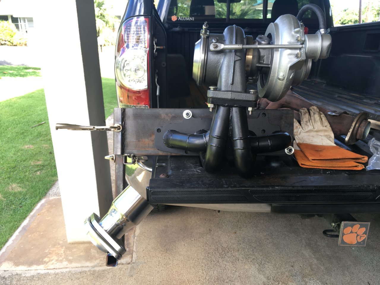

    Did a little jig this morning
    :kona:
    BE54EBCC-E0C1-4AA3-B1B4-B3E133A579D3.jpg 22F4E907-7785-43C0-9E9F-776F14D59F34.jpg
    22A9D93C-CEE8-4F1A-A001-5CC0112B16EC.jpg 5F7A62E6-F98C-4377-8D19-50C819958D08.jpg

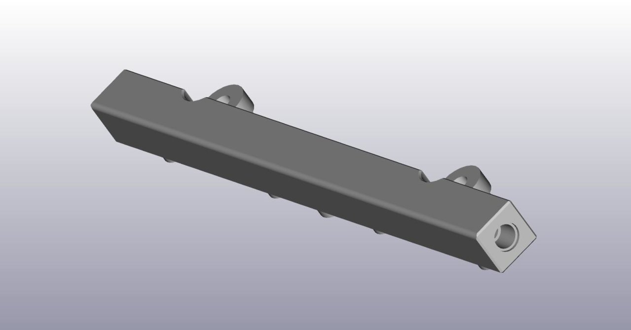

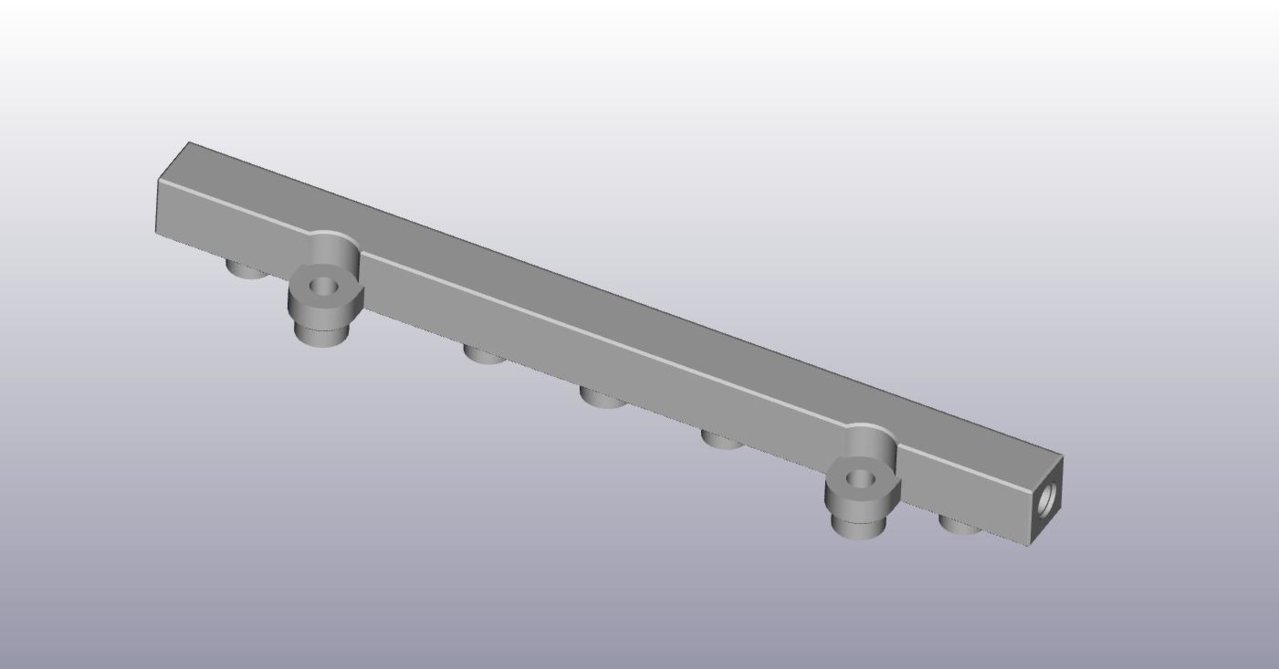

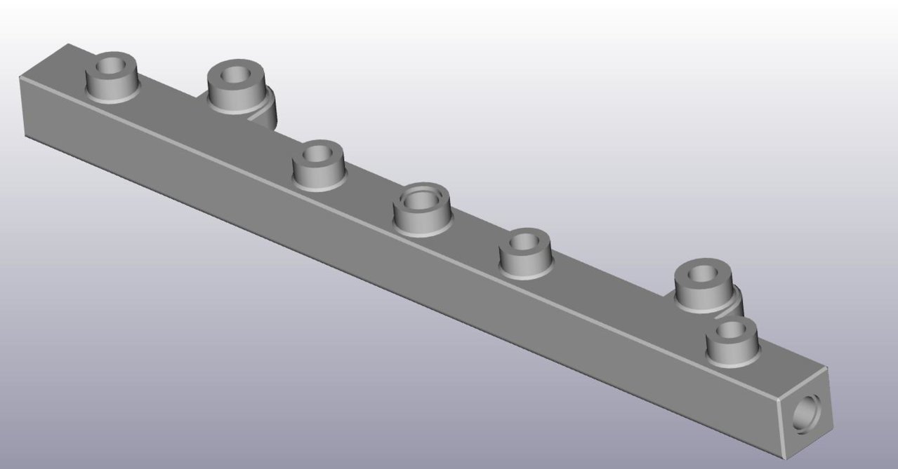

    2TR Fuel Rail
    ORB-6
    2TR-FE Fuel Rail Top.jpg 2TR-FE Fuel Rail Bottom.jpg 2TR-FE Fuel Rail Inboard.jpg
    Depoxy, MadTaco461 and boostedka like this.

    Umm.... Is there one to many holes on the bottom of the rail? I'm guessing the center spot of the three in the center isn't an injector? Otherwise, it looks cool.

    As it was explained to me, you could have fuel enter the bottom port and out both ends to a dual inlet bypass regulator.
    If you wanted an in-one-end and out-the-other setup, then just plug that port.

    Ah....I see. I would just do the "in one end and out the other" which is the standard configuration and eliminate the center feed port as most people wouldn't use/need it. Also, it adds an additional failure point to the system.

    I will be using the one in and two out method for my setup. It's a theory I have seen implemented before. More of a "manifold" that helped lower the fuel pulse, and seemed to not starve the cylinder furthest from the supply under high demand. It worked well. No more lean rear cylinders on the race motors back home :notsure:
