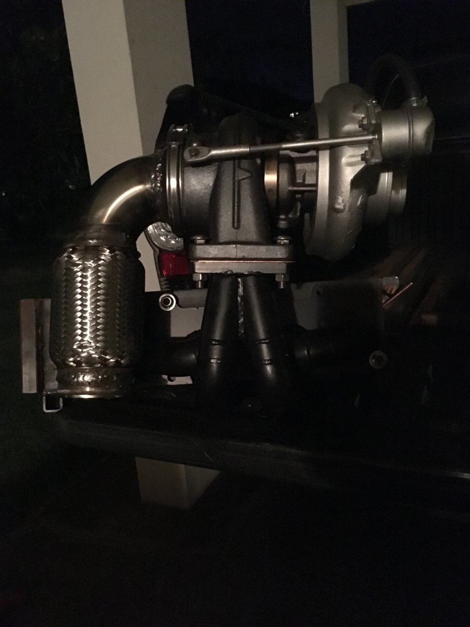

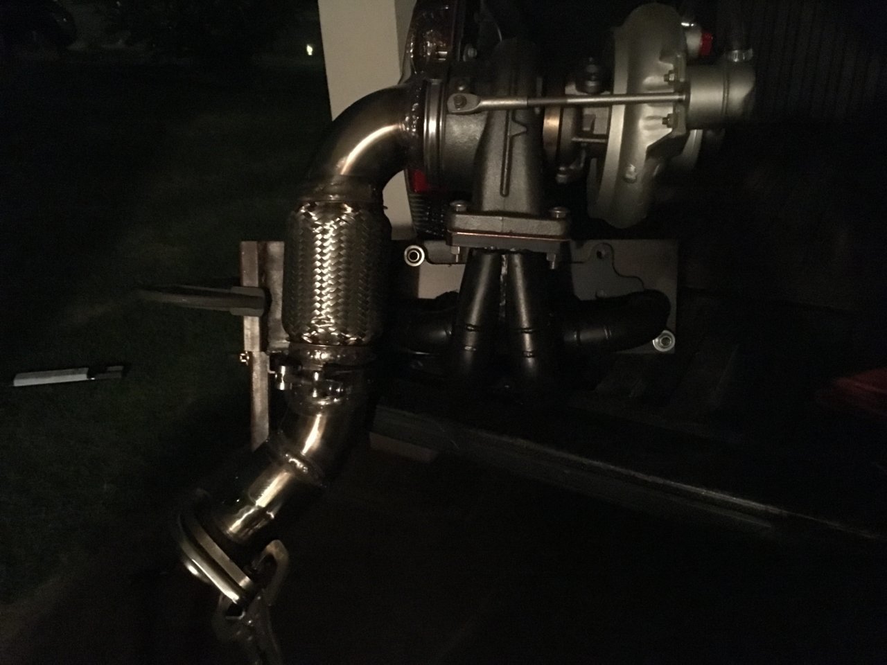

    Stainless everything except Holset to 3” adapter (mild steal), 309 rod throughout. I put in a disconnect post flex in case I decide to run 3” all the way back, currently adapted to stock 60mm.
    Paint tomorrow, more pics to follow.

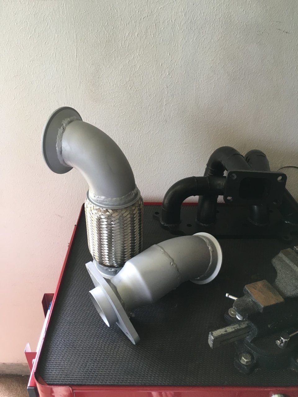

    Just finished painting

    That looks great .

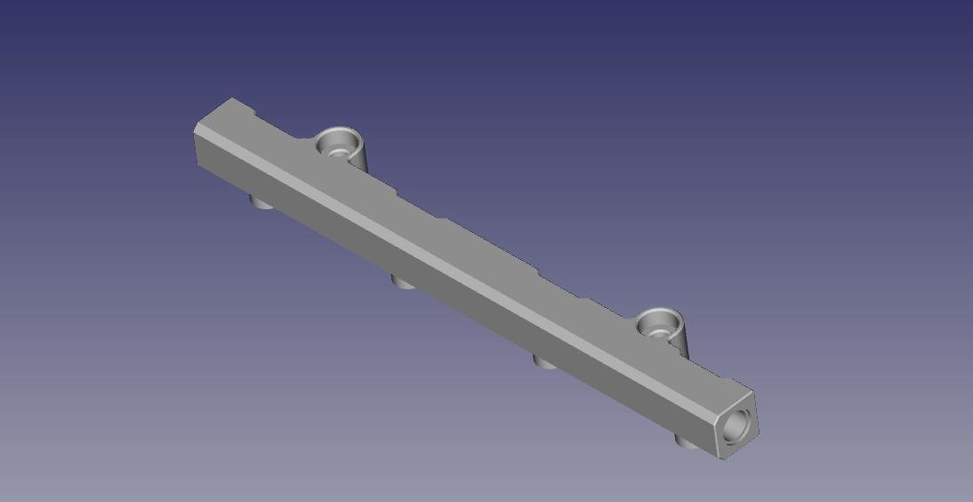

    I'm reconsidering that 2TR fuel rail design because space is limiting me to put the inlet port on top- it looks bad :-/
    Single in/out, 8-ORB BOSS:
    2TR-FE Fuel Rail - TRD.jpg 2TR-FE Fuel Rail - Plug.jpg 2TR-FE Fuel Rail - Injector.jpg
    I'm waiting for my injectors to arrive, will measure and verify dimensions. I'll probably have something cheesy like "TRD" engraved in it.... oh I know, "2TRD" lol

    I prefer this iteration. :thumbsup:
