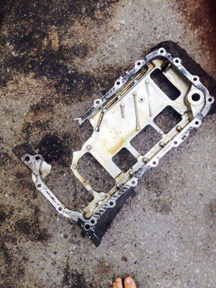

    Wait, you left them in place, but removed the chain?
    The reason that LCE made the balance shaft delete kit, is even though the balance shaft is in the bearings, it allows too much oil to pour out, because there is no hydrostatic wedge being produced by the rotation of the shaft to keep the oil pressure up. There will also be an excess of oil leaking out through the tensioner that is now fully extended because of the lack of the chain.
    That is how the rod came through my friends block.
    Sorry.. you did so much assembly already.

    So the tensioner meters oil by how far it's extended? Even if I rotated the balance shaft bearings to close off the holes I'm still screwed?

    You can rotate the bearings and that will help with the leaks associated with the shafts. The tensioner is not intended to run that extended, and although it's not been observed under running conditions, it's a logical point of failure and leakage.
    You've been through a lot with this engine. Would hate to see the tensioner become an issue so I would reccomend taking care of it preemptively.
