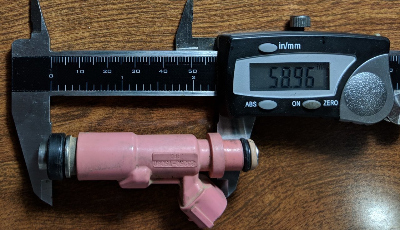

    Does anyone know the stock injector height for the 3rz? Is it 60mm?

    Not sure the actual number but if it was shorter or taller it wouldn't fit properly between the fuel rail and the head. By the way I have some Osidetiger 440cc with the adapters if interested :D

    #28470
    13,431
    CA
    99 turbo 5 lug long travel
    Kinda stock

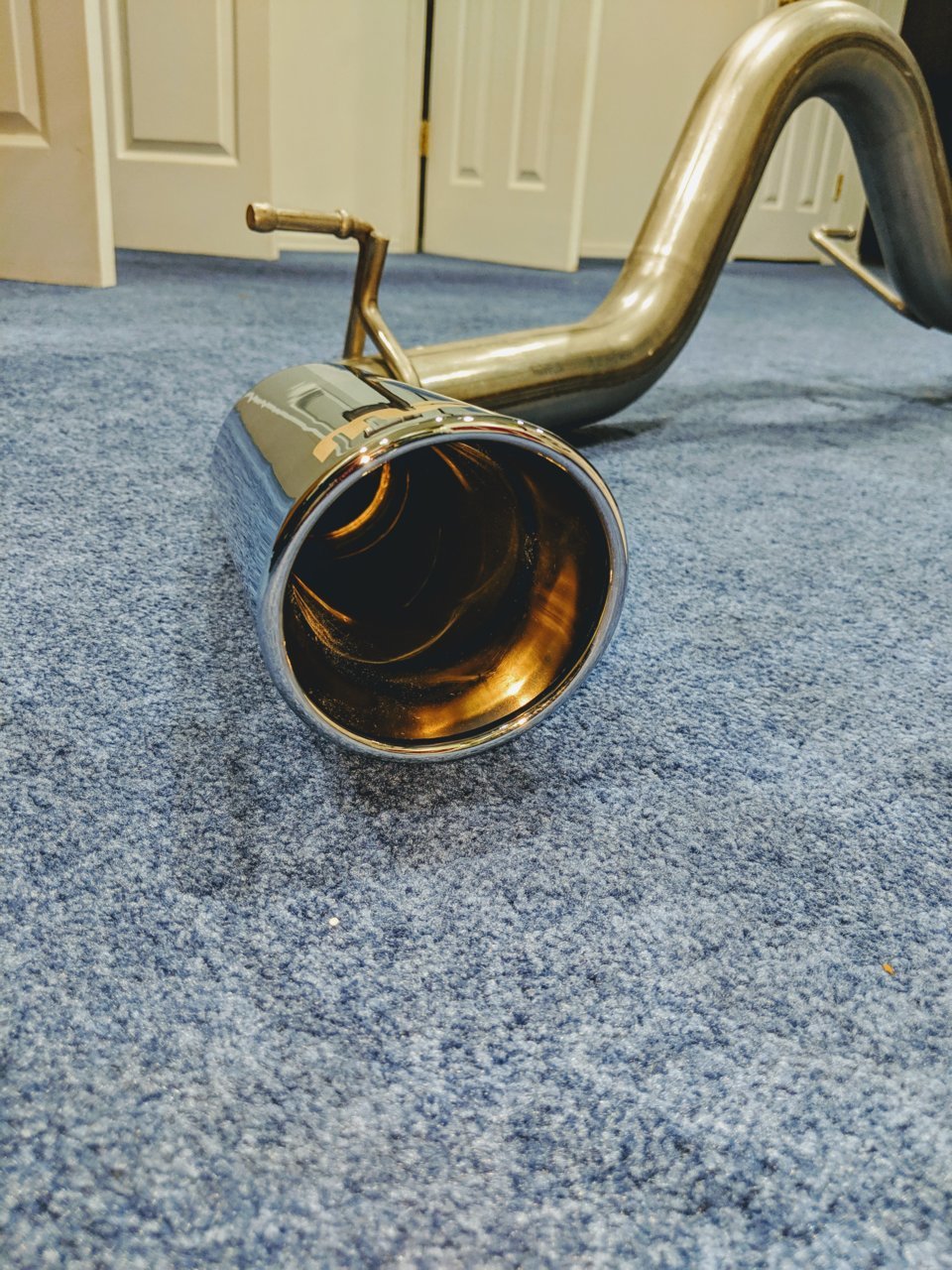

    GTX 3071r @8psi...
    Well this should flow a little better than stock :thumbsup:
    Magnaflow 15240 -> 2.5" from cat to muffler, then 3" muffler back, to 4" tip (Ladies love a nice big tip).
    I'll eventually be getting a catless pipe made up in 2.5", and I'll use URD's rear O2 sim.
    Scored it on Black Friday...normally $590-600, got it on eBay for $410 after the 15% coupon for using the app, and Black Friday discount.
