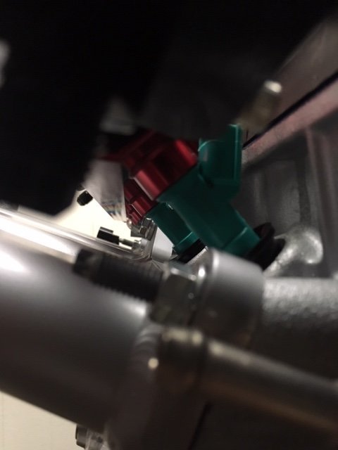

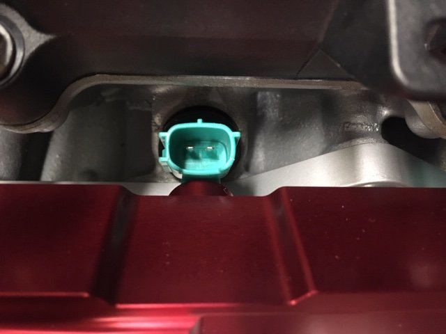

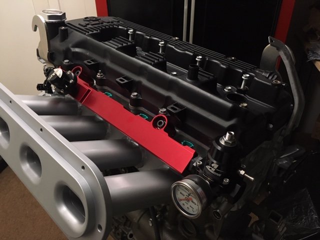

    Installed the balance delete...
    ... and fuel rail :D

    Looks like it’s coming along nicely!
