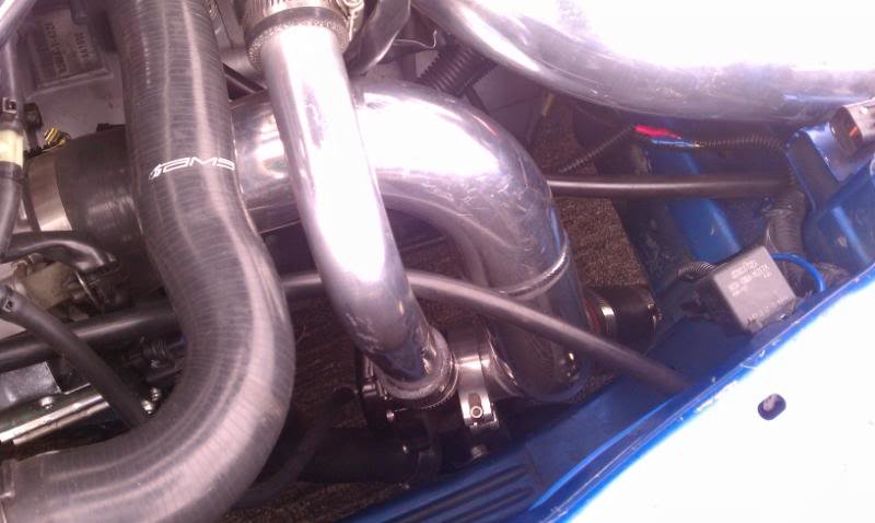

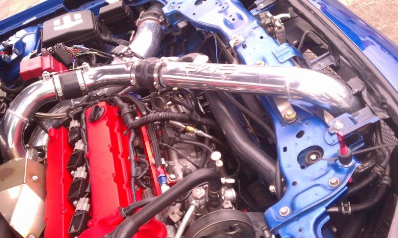

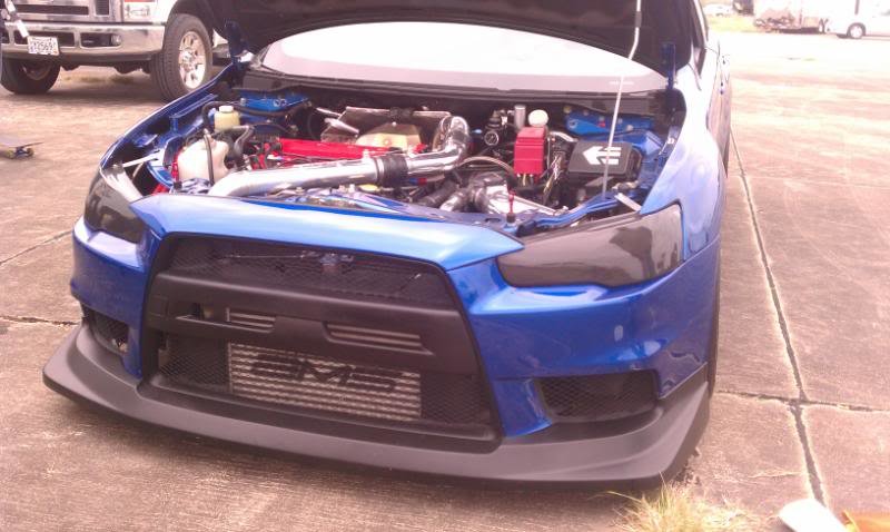

    @Blackdawg is correct.
    Here is another example.
    MadTaco461 and Blackdawg like this.

    And yet another reason why I like my EFR turbo so much. :bananadance:

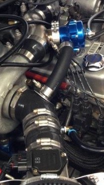

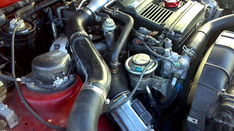

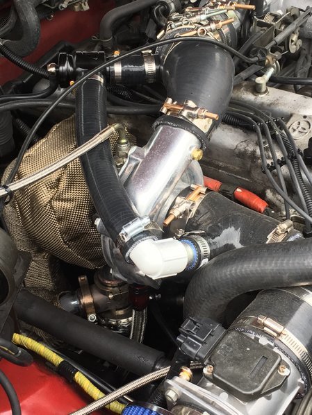

    IMG_5626.PNG.jpg IMG_5586.jpg So what exactly is wrong with these two examples

    Yours is clearly on the other side. Or is his????

    I don't see anything wrong with your setup. You blowing off post MAF and Recirculating post MAF as well. Should function properly. The air that has already been metered is staying in the system.

    His setup is right. He just probably has an air leak somewhere so when he lets off the gas he is pig rich and stalls.
    Blackdawg, Jstand and Torspd like this.

    It means that something else is affecting the setup. Something with the bov, or other.

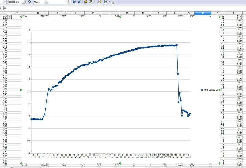

    Here is a quick wot log of my car. x- axis is the column number logging at about 10hz. y axis is maf voltage. I didn't show rpm but I started @ 2.5k to a pull to about 6.5k with an immediate throttle let off. My bypass valve is recirculating. maf voltage peaks at 4.3v and only dips to about 1.5v. I'm still pulling in air into the motor while the motor is slowing down. I cut off logging about 5k rpms. So at 5k I'm pulling in 1.5v closed throttle. Closed throttle my throttle body is open at 2.3% No air is being vented off for this entire log.
    boostedka likes this.

    That spike proves my point. Its not always going to cause you to stall but you can clearly see a spike in the MAF voltage right after your let off the gas. Do you happen to have a map of your ARF's to conincide with this? I'd be curious to see how rich you were at that spike.
    It looks like with the TB closed, and at idle MAF should be around 1.4V (its hard to see the numbers).
    When you closed your TB, the MAF voltage droped to ~2.05 then spiked back up to 2.5V as the air flow reversed, before dropping again.

    I logged everything. I can post the excel file. You are right that it is going to be pretty violent. My afr is showing full lean because of fuel cut. Keep in mind that each dot is a 1/10 second log with no smoothing. The maf voltage will fluctuate a bit, but you aren't going to be leaking air out the maf with a recirculating bov. I'm going from 290g/s to high 20 g/s in a quarter second.
    I don't run my car aggressive compared to the big hp guys. Front wheel drive can only handle so much, lol.
