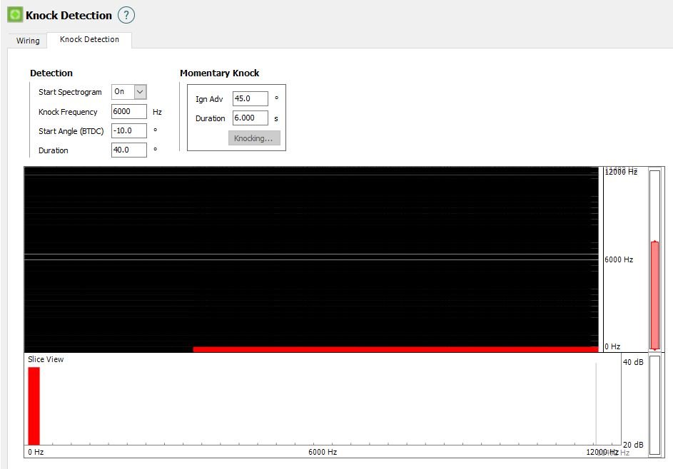

    Ok, so I ran the test at 6000Hz (I believe equation told me it would occur around 6400Hz) with 45 degree advance- engine ran like shit, sputtering and such.
    I see nothing

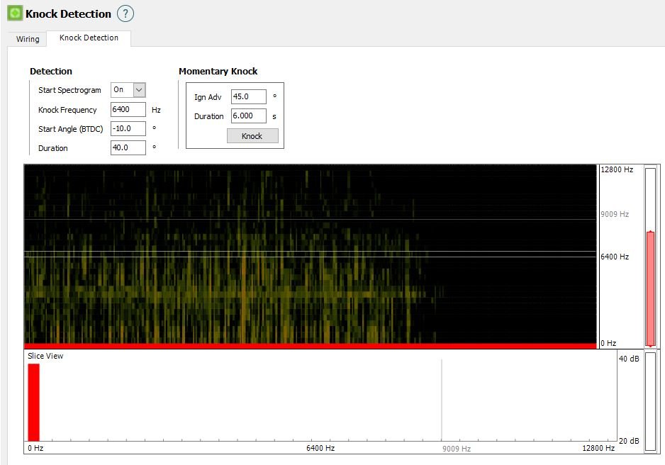

    Same results with 6400Hz, I hear the popcorn I read about but nothing on the graph

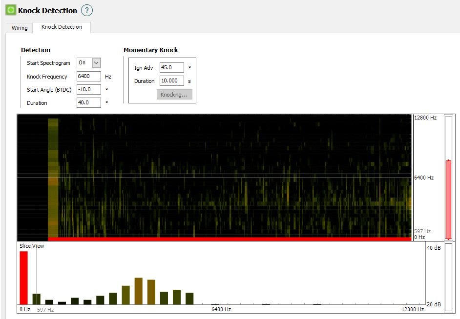

    That's without pressing 'Knock'.
    Here it is with 'Knock' button pressed
    What now?

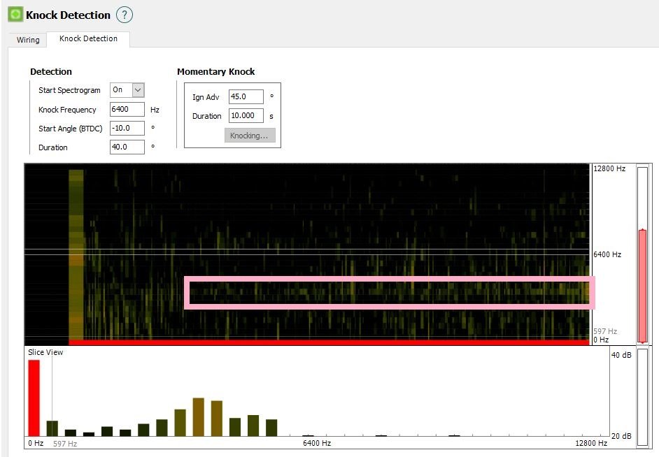

    I'm seeing almost a solid band of noise around half that Hz, and the bar graphs at the bottom showing the same. Should I change that Hz number to 3500 and run again?
    edit:
    I'm referring to the band in this pink box ;)
    edit edit:
    the taller bar at the bottom is 3800Hz

    I guess what I need is an interpretation of what's going on here ^
