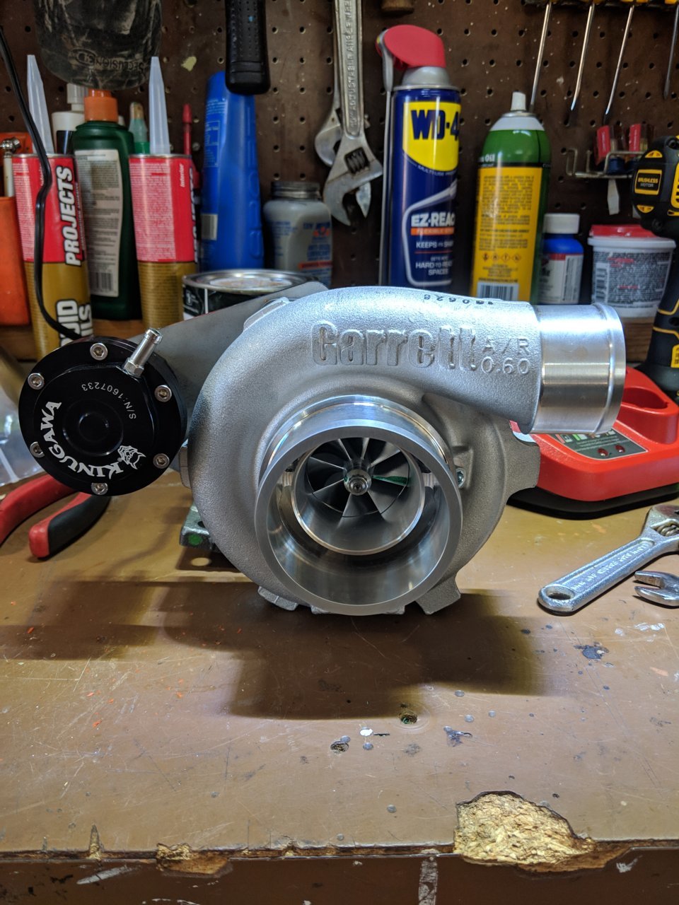

    For a second I thought "Garrett" said "braaaap" haha

    That thing looks effing sic!
    What are the specs on it?

    Gtx2860r gen2 with a kinugawa waste gate actuator set for 7 psi.

    Sic! Ball Bearing?

    Yes sir dual ball bearings

    Damn, that's going to be some fast spooling. Nice choice
