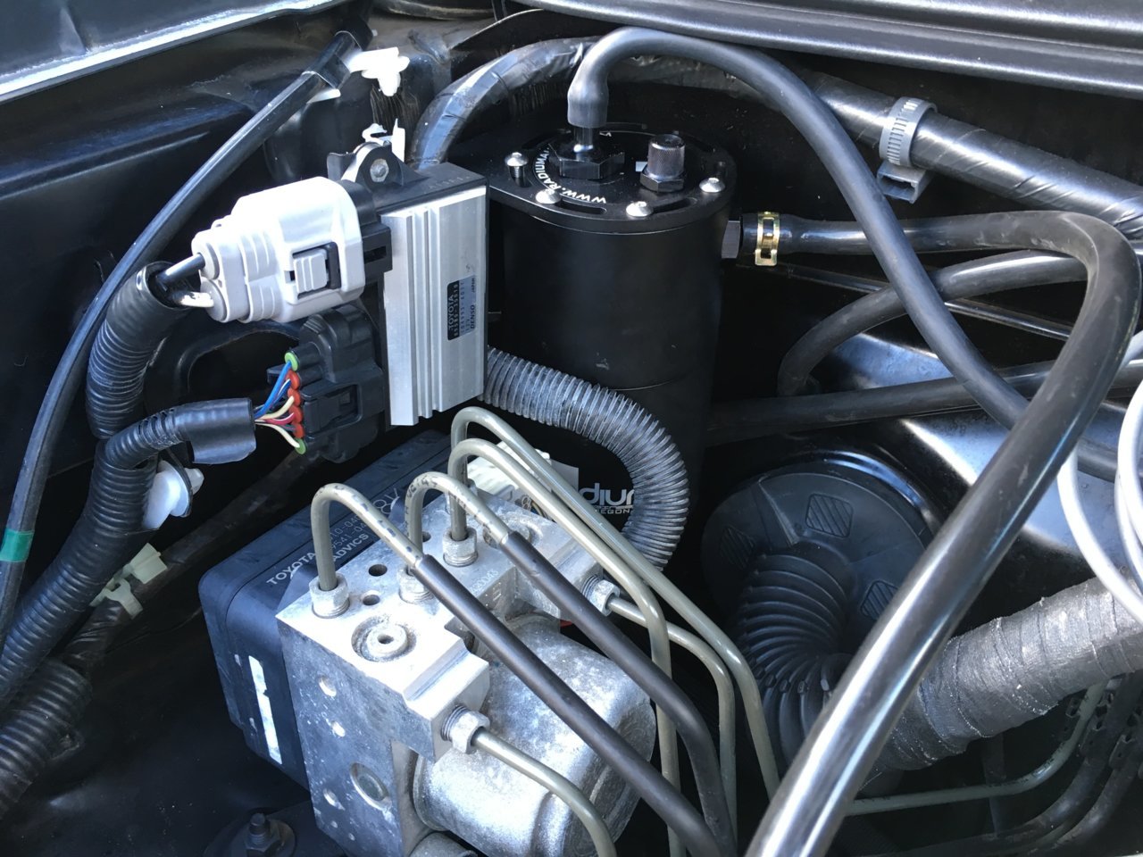

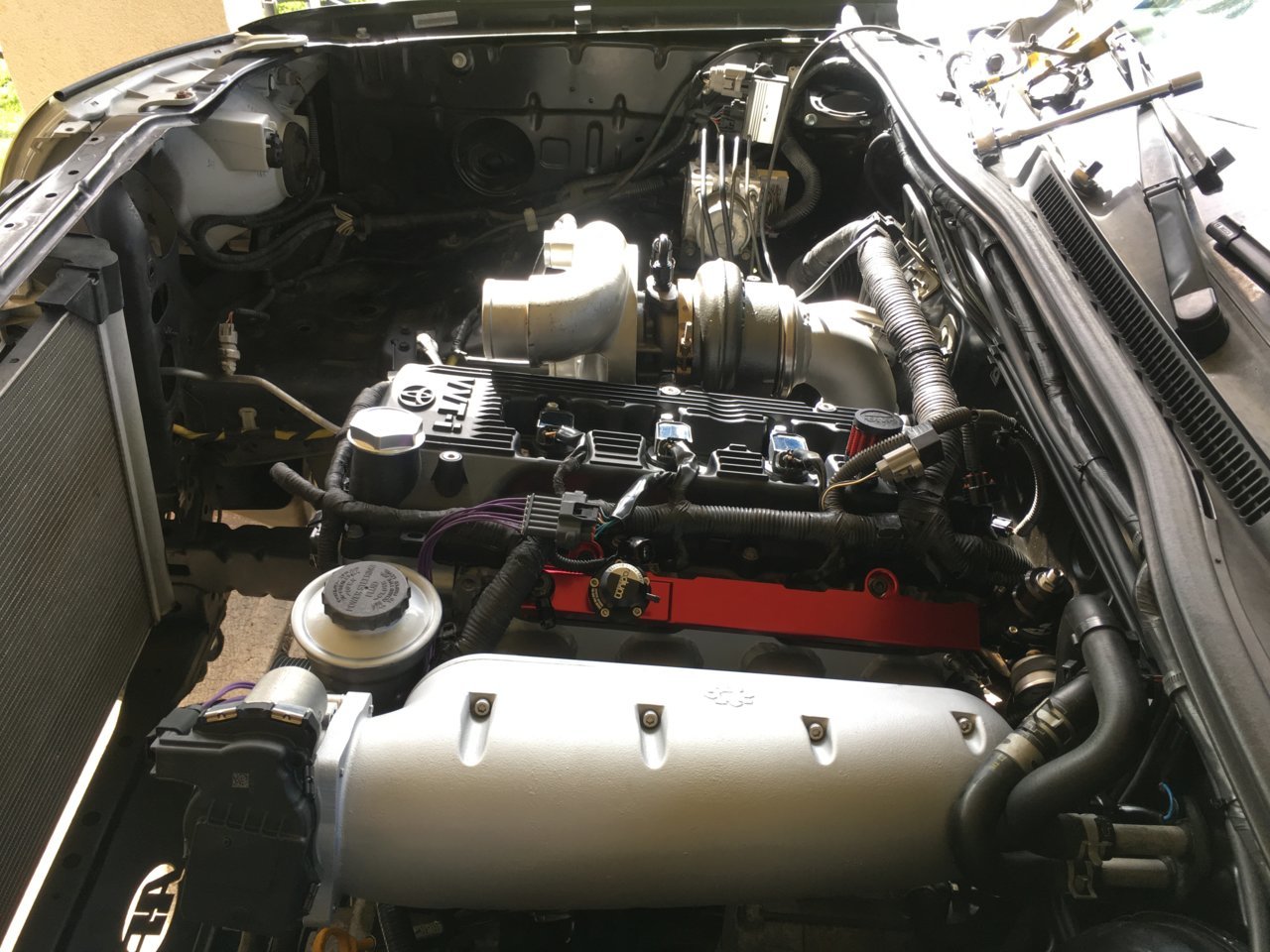

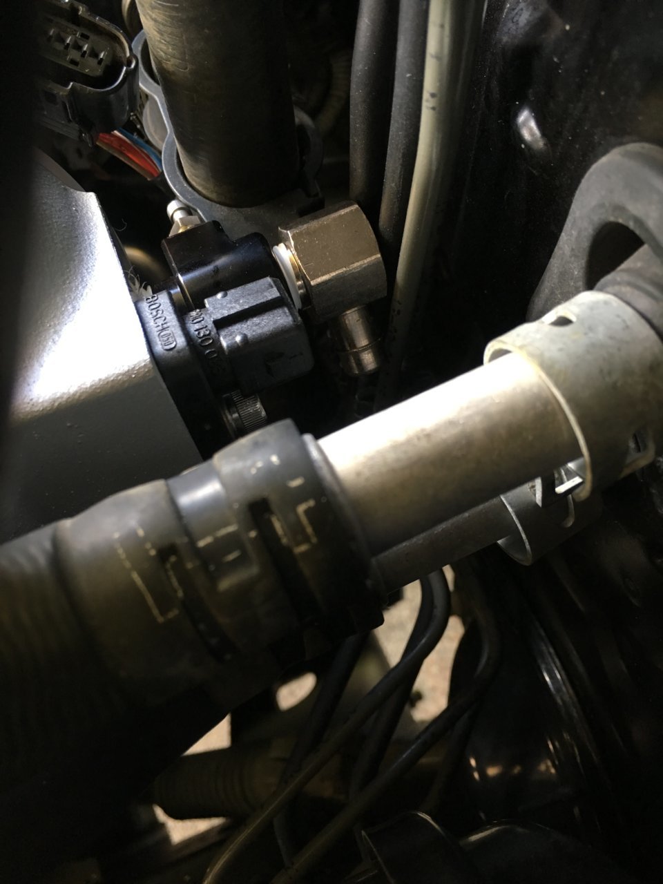

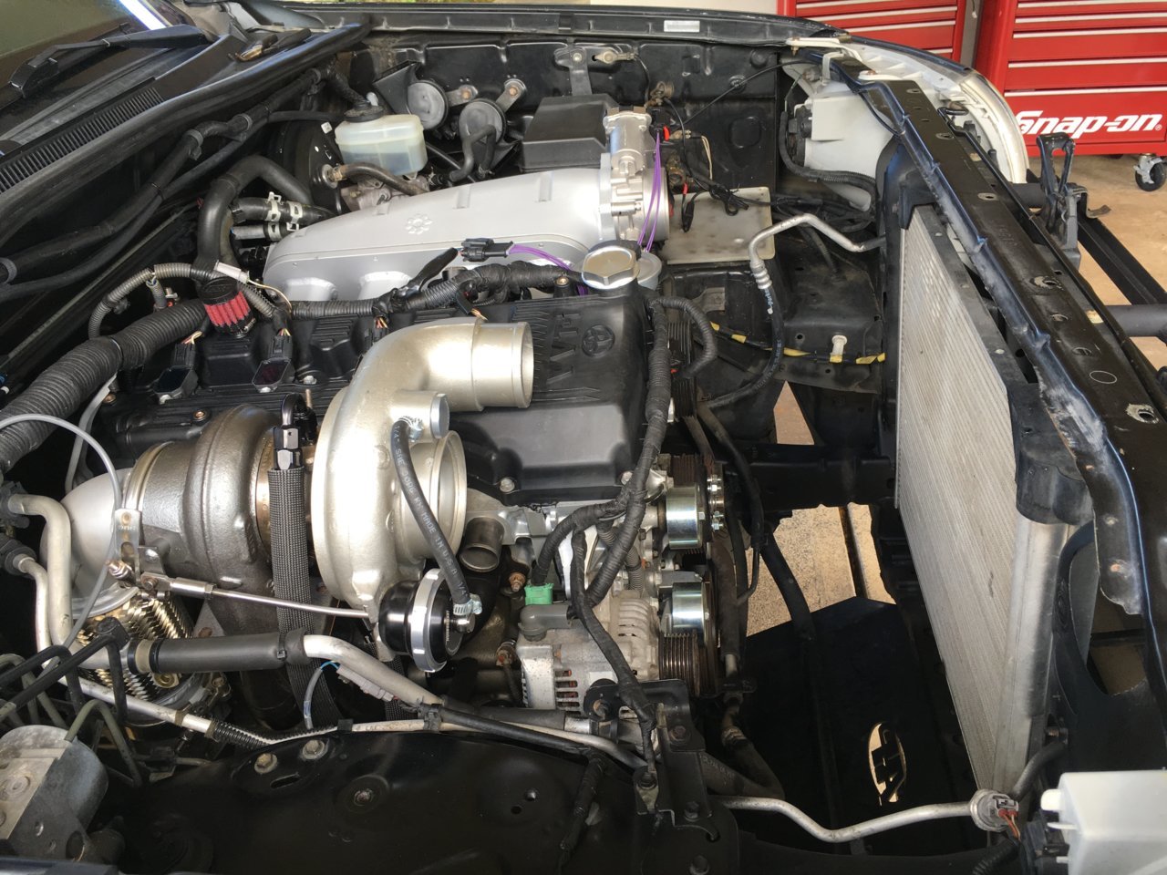

    IAT from Bosch, calibration file provided by Haltech as VW 1.8

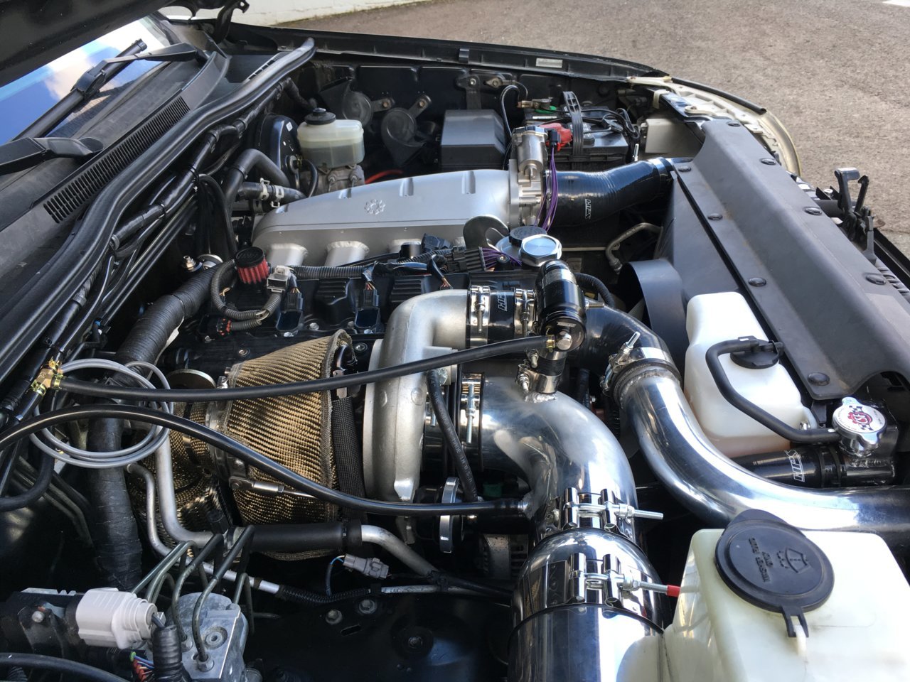

    Tight, likely give those brake lines more room. You can see the MAF plug in upper left corner, reloomed the harness and directed to new location. I made a pnp harness to attach.
    Hemi 80mm with pnp harness
    Holset HE351CW
    My custom fuel rail with Aeromotive regulator, Radium Damper, 650cc injectors and Aeromotive pump
    CSF FJ radiator and shroud with Evans Waterless and 180 thermostat.
    HPS silicone throughout, to include coolant and vacuum hoses
    PTP blanket and matching downpipe wrap
    4” intake from stock sidewall hole, reservoir shaped as if it was born for it
    Radium AOS-R nestled in the corner. The Hemi 80mm doesn’t utilize coolant, so I diverted those lines to this
    Turbosmart Wastegate actuator and BOV

    It looks amazing man. You can see all the work put into it.

    Almost looks oem! Loving the rubbah slippah garage action.

    WOW! That is fucking clean!

    Too bad the 1gr intake inlet isn’t on the opposite side. When’s eta on first startup?

    Yesterday lol

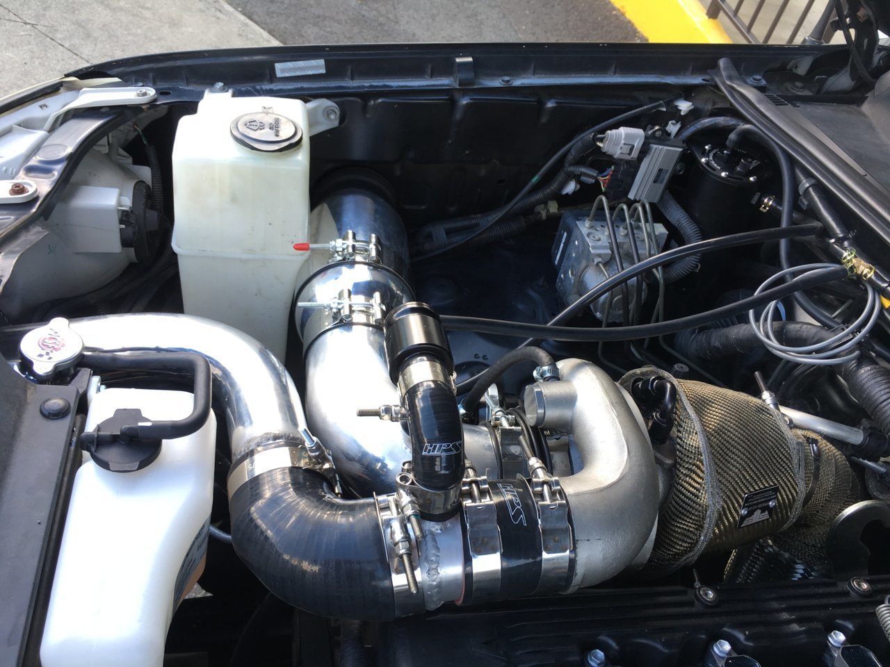

    Those AC lines are running very close to the down pipe and turbo. I wrapped mine with a heat shroud similar to this: https://www.amazon.com/Design-Engineering-10457-Heat-Shroud/dp/B01MZZHXMQ/ref=mp_s_a_1_3?ie=UTF8&qid=1548267208&sr=8-3&pi=AC_SX236_SY340_FMwebp_QL65&keywords=heat+shroud&dpPl=1&dpID=41z6b36nrdL&ref=plSrch

    Thanks for the heads up, I’ve got similar on the way and still need to wrap the harness above too. I’m considering sleeving the vacuum lines going across it too.

    Yeah, I wrapped the down pipe on mine to. Another member had their ac lines melt and blow.

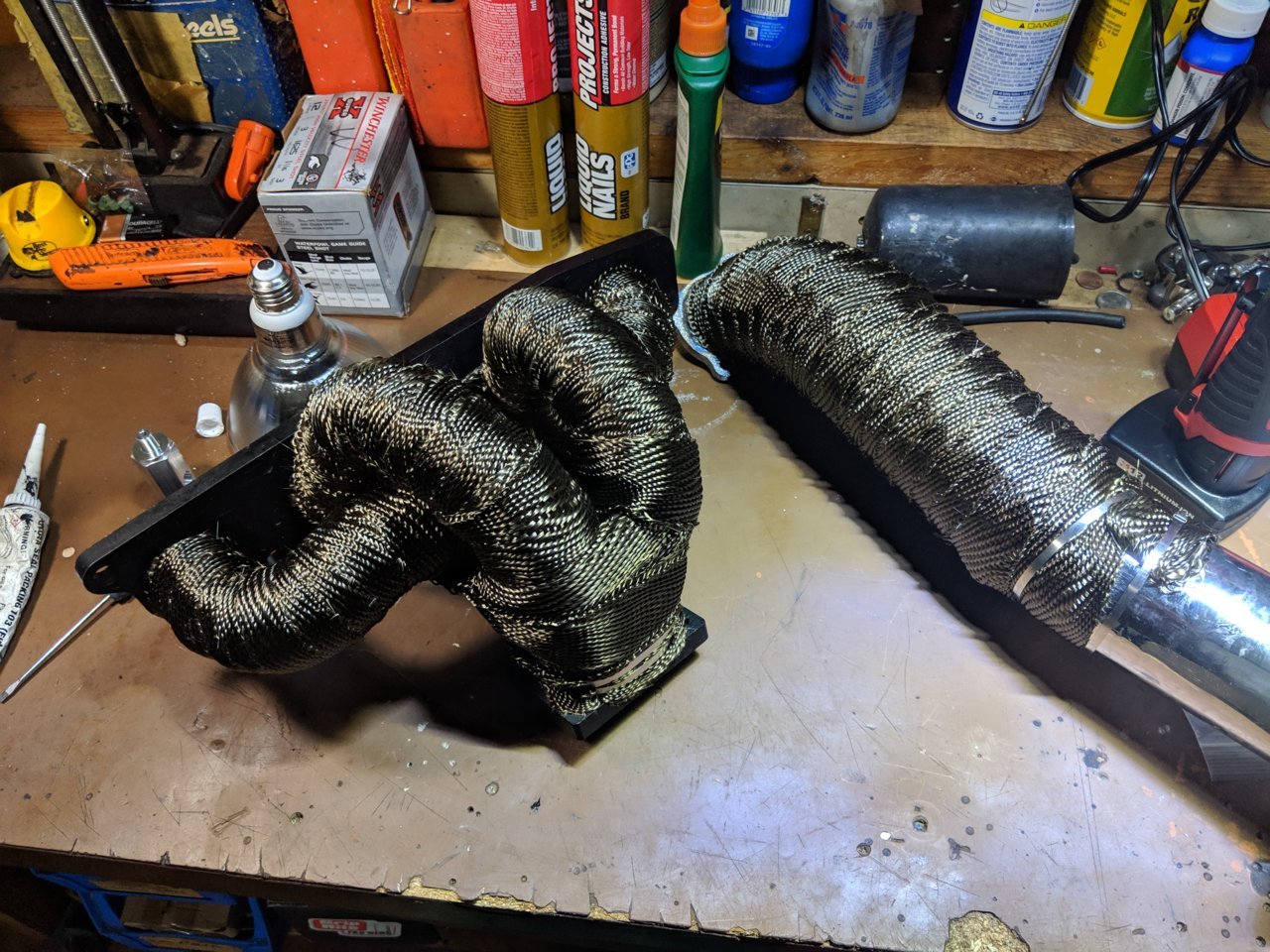

    My first attempt at heat wrapping lol. I'm sure one day I may change it but for now it should work. This stuff sure loves to fray.

    Looks good. It'll fray until you spray it with the black silicone spray paint stuff. Then it sets up hard and doesn't fray anymore.
