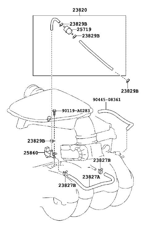

    What to do with the VSV? I connected the harness but it's to atmosphere atm

    I have mine just blowing into no man's land. I get a CEL every few startups, but no limp mode. I'm looking into the Hewitt Tech bypass, as I'd like to just remove it altogether. I know KirkRio used a resistor to bypass his, but that won't work for my year I believe.

    I'm talking about 25860 in this pic, for vapor I believe
    I unplugged the air pump and unbolted that bad boy, no problems here but I'm not using the stock ecu anymore; I'm thinking I'm good to remove the Vacuum Switching Valve too but want to make sure it won't screw with my fuel system.

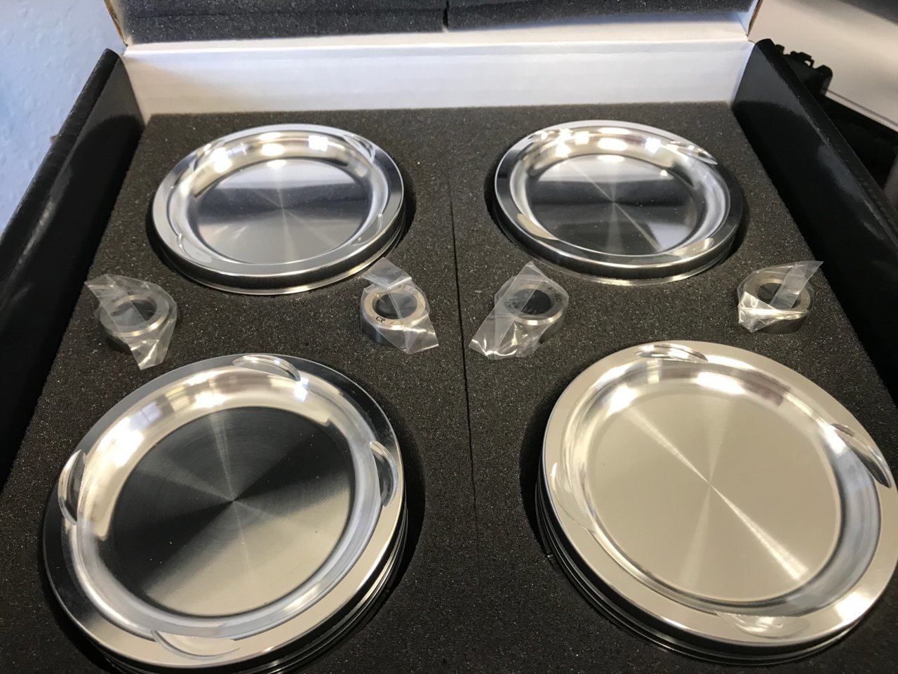

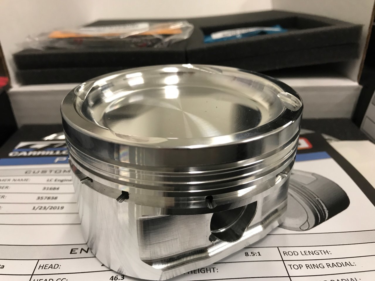

    Hey but seriously, there's a trick to installing those clips. I'm not even going to try and find the link I posted but that video made night/day difference on piston 2-4 lol
