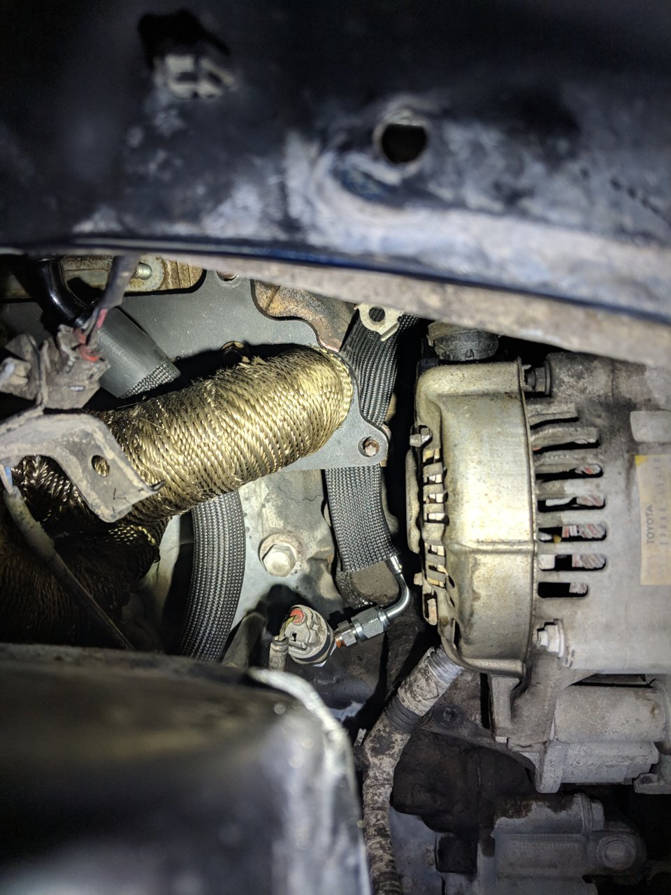

    Do you ever want to just cry
    MrCrowntown likes this.

    Please tell me you didn't accidentally crush it?

    What line is that?

    Ouch!

    At least you caught it before you burned it up, or did you?

    More like crimped it :/
    Oil feed

    :pout:

    No turbo restrictor need now. ;)
