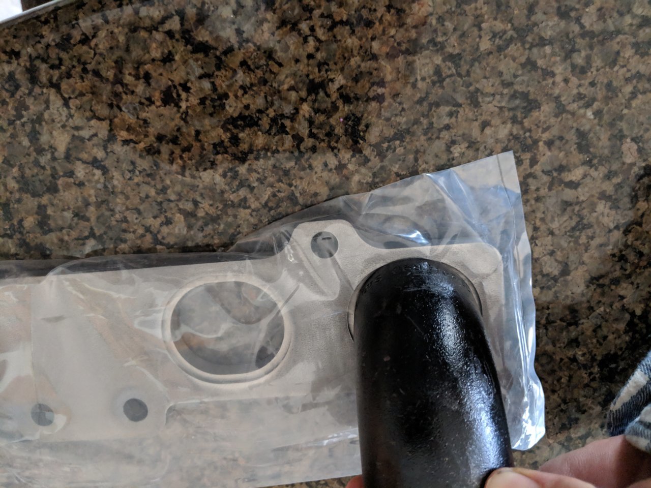

    Now that is interesting. Lol. I like what they did there.

    Unfortunately they machined the other side to hold the pipe. It's their long tube header flange.

    After spending a little more time looking at the flange, the ports look ovular. This is correct? If so how will that affect using the schedule pipe?

    More work that I want to fill in those cuts to have the carb side out. It is oval. Might need to do a fillet weld on the inside too to correct the flow and fill the gap. Top and bottom is a near perfect match.

    Run it and see. Mine is close but I also wrapped the pipe in insulation.
