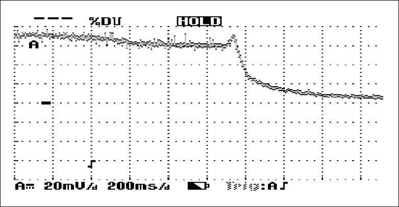

    Same principal, different application. Fluid line, pumping hydraulic oil has static pressure of "xx" psi. Motor still pumping, line valve is closed. (For the sake of this argument, closed to 96%. Simulating a idle postition of closed.) With a pressure gauge attached in that line, you can watch the line pressure gradually increase, as the valve is slowly closed. Up to "xxx" psi. Same fluid dynamics. Bypass valve or pressure release valve, or reopening the manual valve, brings the pressure back to normal.
    Again. Different application, but same principals happening. Both are F/I pumps. Liquid or air it does not change the fluid dynamics.
    This is also why fleet vehicles have known turbo failures, why silicone couplings burst, charge pipes blow out of couplings, and shaft play inducing compressor blade/housing contact happens. Already dealt with it on one turbo. Recorded the pressure problem impacting the turbo operation even.
    Save the turbo. TB engines are more stress inducing than non TB enegines. I.E. Diesel. Doesn't mean that diesels don't greatly benefit either though.

    I understand what you are saying; I'm just saying it’s been measured :notsure: The spike in pressure was about one additional PSI. If you are running a turbo balls out to the limit, that one extra PSI may be the straw that breaks the back but I think most people would be ok with that small spike.
    Here's another good explanation:

    Another discussion if you are interested:
    http://www.mr2oc.com/61-3sgte-turbo/445311-removed-my-bov-what-difference.html
    And I found the boost spike mapping with no BOV:
    Furhter in the discussion you see that the BOV actually isn't able to react fast enough to eliminate the spike so it makes no difference either way:
