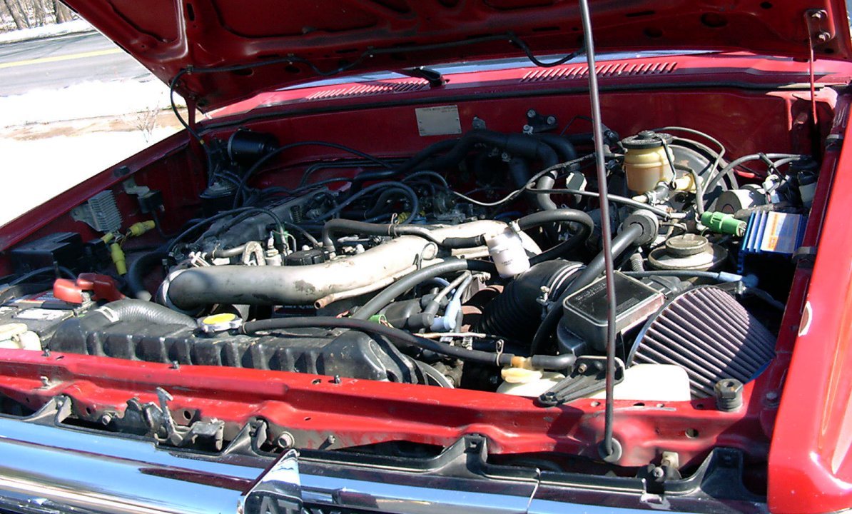

    You probably need some sort of catch can for the oil. I had an older 87 4Runner with the turbo motor and it would always pull some oil through the pcv so I went to one of the parts stores and found a plastic fuel filter with the inlet and outlet at the top and plumbed it into the pcv line. It actually worked pretty good. You can see it in this picture.
