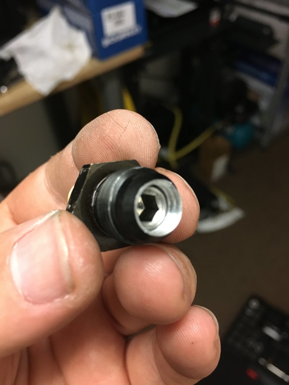

    I run a .04" restricter on my journal bearing turbo. My motor just pushes a lot of oil and I don't boost that high (under 15psi). 4an feed, 10an drain with a nice big drain flange that matches the exit port. I haven't had any coking or overheating of the turbo. If I was 20+ psi I might have some heat issues come up, but I would of bought a water cooled turbo.

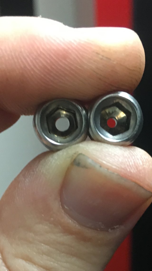

    6an in and 10an out for me but is supposed to be 4an haha
    Before I enlarged my out to 10an I was running a diy 1.5mm restrictor and was good.
    Threaded and set screw insert.
    Left one was too big, still got smoke but not with one on right.
    E9B92307-2FCD-489D-89E0-A563FE40ECCE.jpg 53995F4D-AC91-4065-9816-10AAA2F1720C.jpg
    I had two more before this, I went smaller with each one until no smoke because I didn’t want to accidentally starve it of oil
