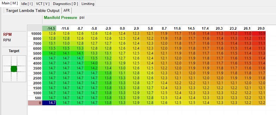

    This is what I'm running, default table. I haven't had it tuned yet

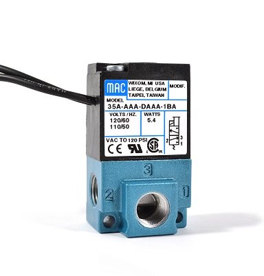

    Hey guys, I'm about to install a MAC 35A-AAA-DDBA-1BA to control boost.
    I'm seeing two different ways to plumb it; both have #2 port going to boost reference but then either #1 or #3 has the nipple to actuator (other has the sintered plug).
    I have a 10psi spring installed and want the controller closed until 12psi and then open. Which way to plumb it?

    I ran mine
    1. Vent
    3. Wastegate
    2. Compressor housing.
    Add duty cycle to increase boost.
    0% spring pressure
    100% full interrupt.

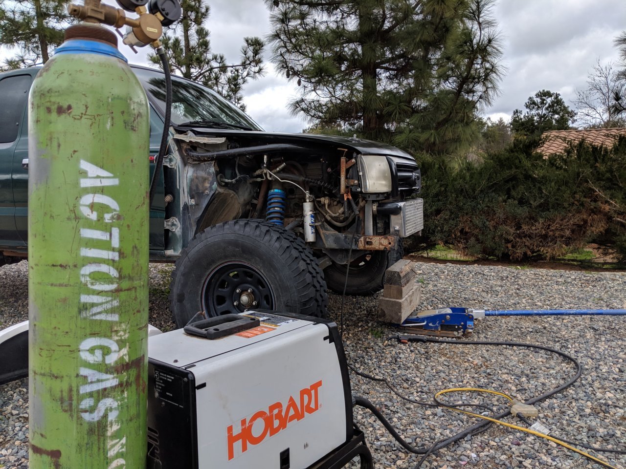

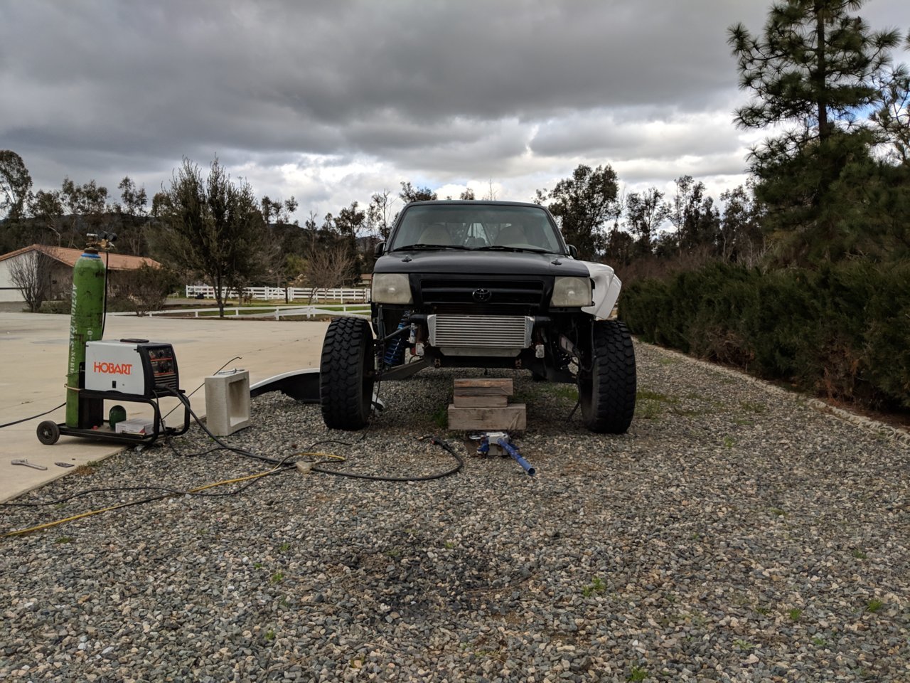

    I mounted up @boostedka old intercooler today. It's big compared to my old soda can for an intercooler I had on it. Just need to make some custom brackets. I'm going to break off that side mount first trip.
    Felt good to wrench again. first weekend it hasn't rained in a while.
