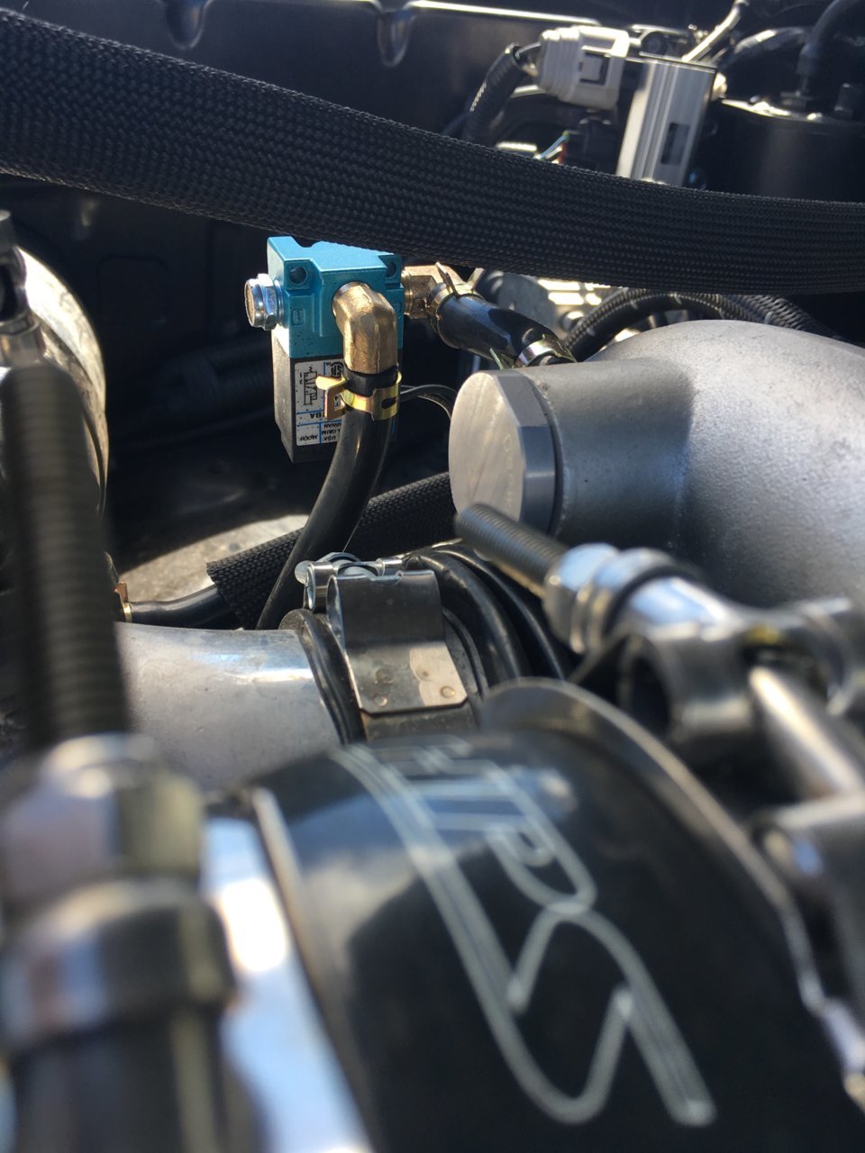

    Soldered in the EBC, it’s suspended in place by the hoses. Smaller than I thought it would be.
