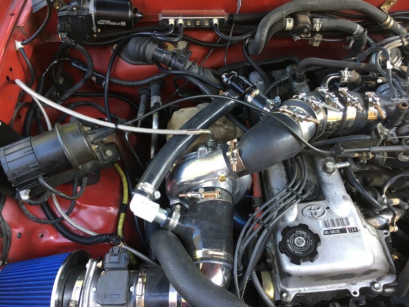

    image.jpg Here is what it looks like

    I sprayed carb cleaner around everything and nothing changed

    Is there a way to block off ur bov or plug those ports and run it with no bov and see if it does the same thing? If it does, its not in ur bov and if it doesnt its in ur bov setup somewhere. That at least will help zero in on whats actually goin wrong

    I ran the Bov to atmosphere and it did the same thing I even changed the bov and it's doing the same thing so it must be something else:facepalm:

    I mean like take the bov off and put a bolt or something in those ports and see if u get compressor surge and the truck doesnt die when u rev and let off. I guess it could be ur maf sensor gone bad but wouldnt it idle and drive in close loop pretty awful if that were the case?

    So at first I didn't have this problem with stalling I'm not sure why it started but here's what I've done so far to figure out why I've changed to a different Bov i've changed vacuum source I've tried Bov to atmosphere i've sprayed everywhere with carburetor cleaner and couldn't find any vacuum leaks that way at least and just now completely disconnected the Bov from the engine and plug the holes and it still does the same thing you Rev it up and let off and it just dies:annoyed:
