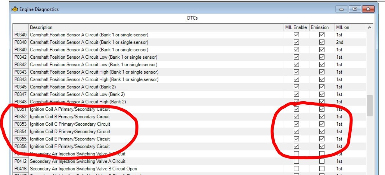

    So I can’t get fancy coils with no haltech?

    :p idk man, not sure how the stock ecu will react with not seeing it. Maybe is another way, not sure. I'm working on fitment and finding GT-R wiring diagram atm. Maybe that's something that can be turned-off by HP Tuners (hint-hint)

    Its basically the coil sending a confirmation that it fired. If the ECM doesn't get the confirmation, it set a fault thinking the coil didn't fire.
    https://www.customtacos.com/tech.ol...06toyrm/06toypdf/06rmsrc/rm2006ta/0050033.pdf
    Provided that is the only function, yes you could turn it off with HP Tuners.
