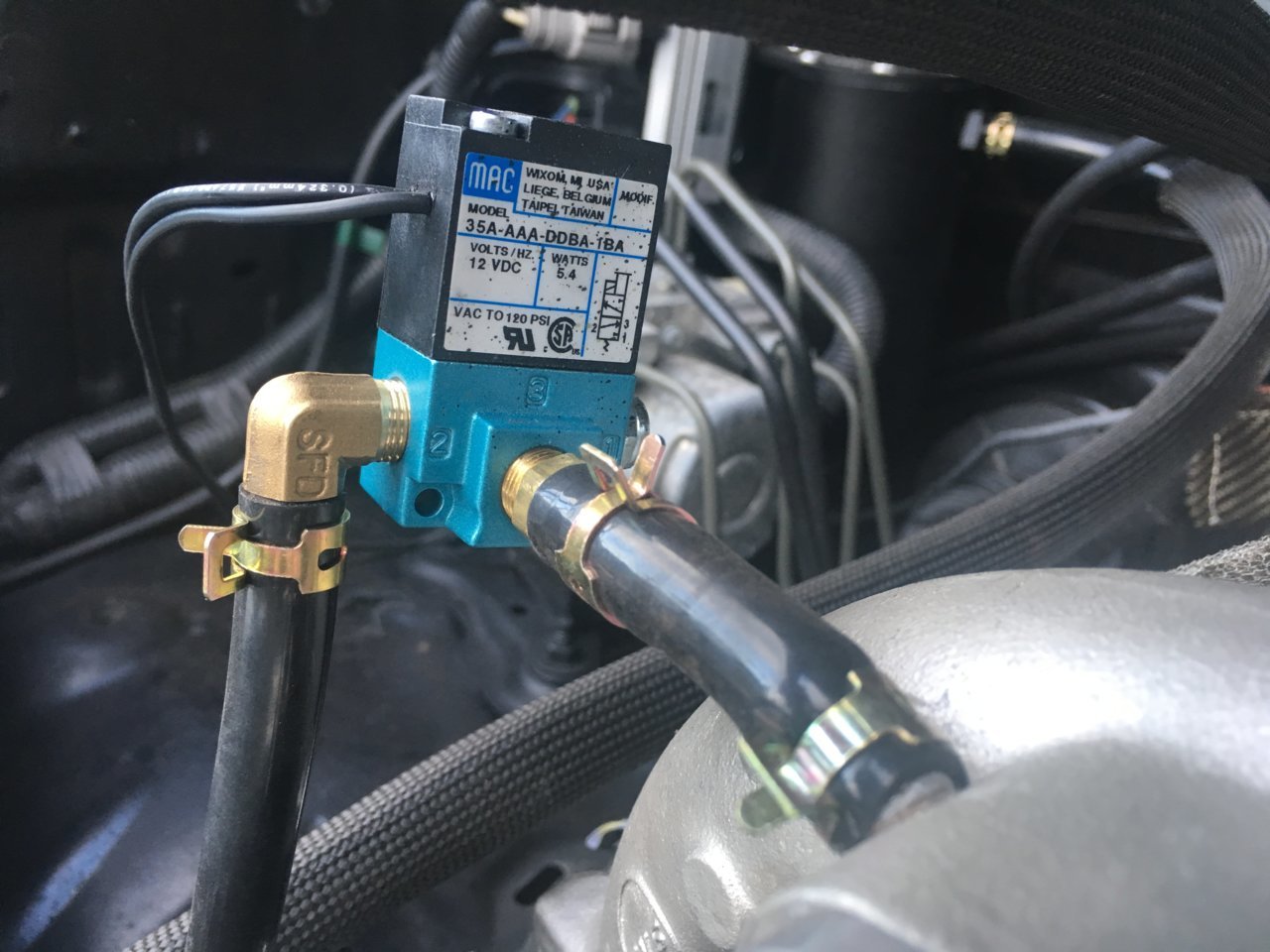

    I just extended the hose coming off the pump and placed the valve in the back pocket behind and to the right of the engine.

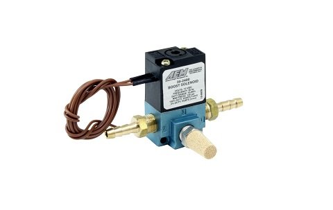

    @arcenik I plugged in your numbers, still not working. I was under the impression the wires were switchable, maybe not?
    Interesting AEM 017-30-2400 is plumbed like this

    Did you verify that the solenoid pulses electrically? Not just by battery, but through the program.

    No, how do I go about that?

    Add a "zero" rpm to the duty cycle map. Do it at the very end on that scale, and it will self populate where it needs to.
    Then, in that column, make it anywhere from 60-100%. You should hear is buzzing away. Then once it is proven, delete that "zero" rpm field.
