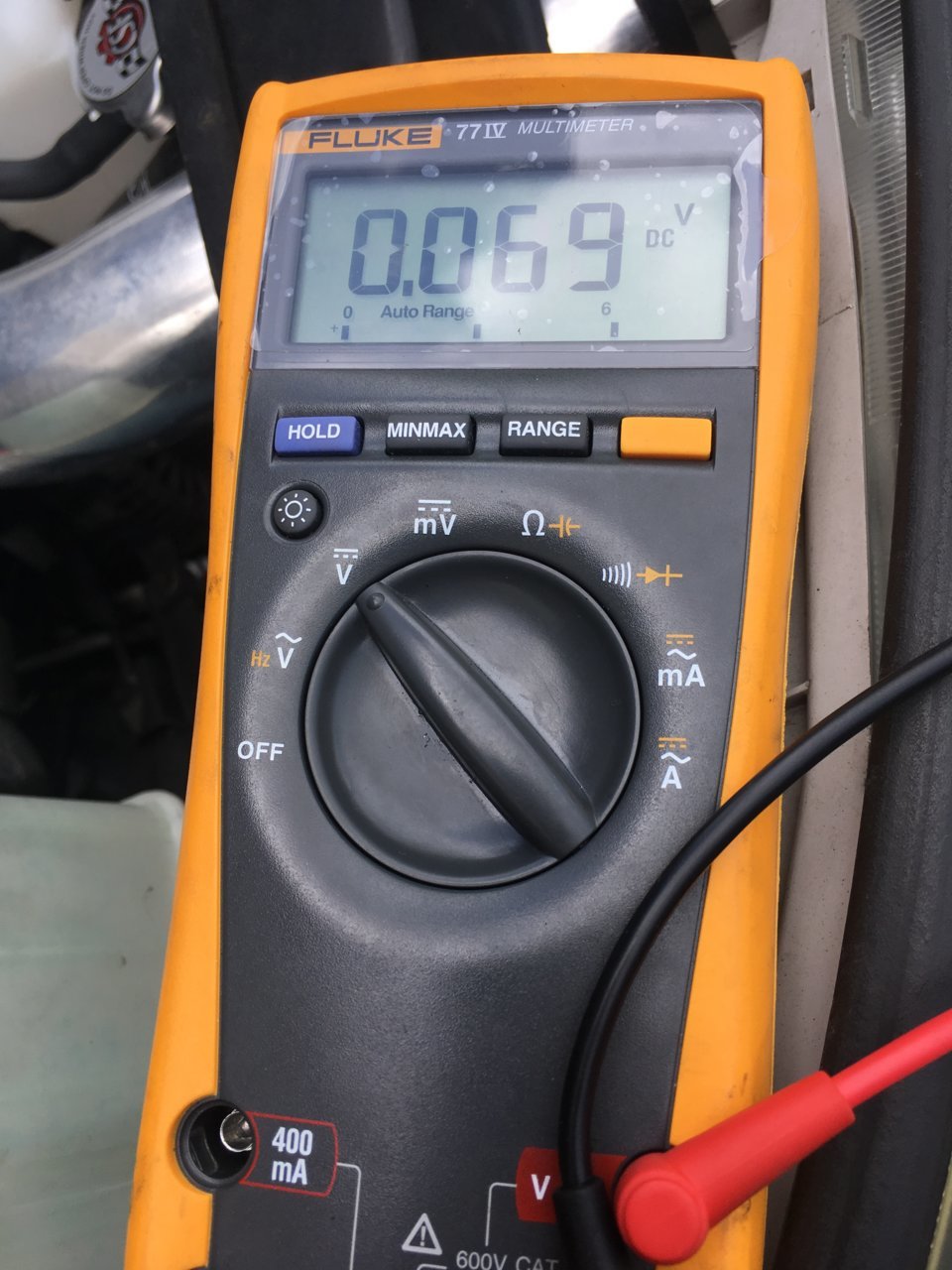

    Think I should have more power than this at the wires

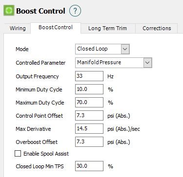

    Turns out the problem was wiring and software- somehow DPO1 was chosen in ESP and my wire was DPO4
    Does everything look good here?

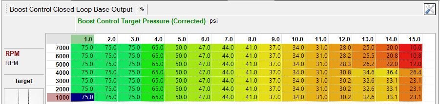

    Basically looks good. Does it hold the boost well, or fluctuate at Max psi?

    Mine holds great with just myself. If I add another person though, that small added load makes the boost behave differently. So much so that it hits boost cut a lot. Needs more adjustment on my end.

    Are you running open or closed loop? Can you explain when/why to run one or the other.

    Closed loop. I just haven't updated the table with the adjustments.

    This video starts on an on-ramp and 60mph cruise on H3 with 4th and 5th gear pulls to see how well it sustains target boost (14psi)
    1:12 > 4th Pull
    1:42 > 3rd Pull
    2:10 > 60mph cruise up long incline
    5:50 > Top hill and 60mph cruise down
    8:08 > road flattens out
    8:11 > 4th Pull (reflects 3rd momentarily due to clutch slip)​
    These pulls gave trim values, table after applying those values
