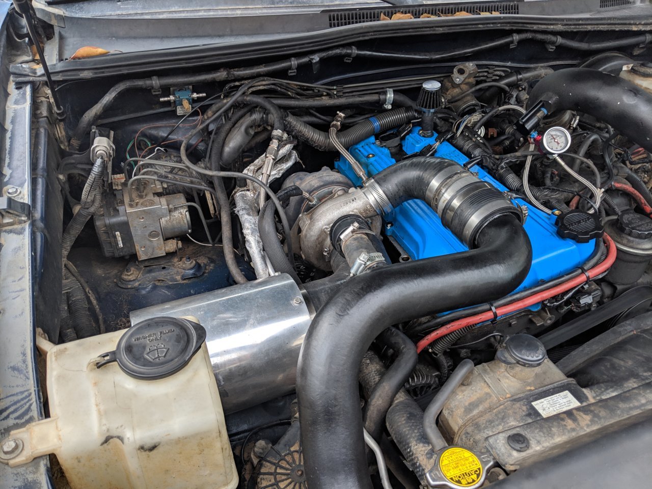

    Pictures of your intake setup please.

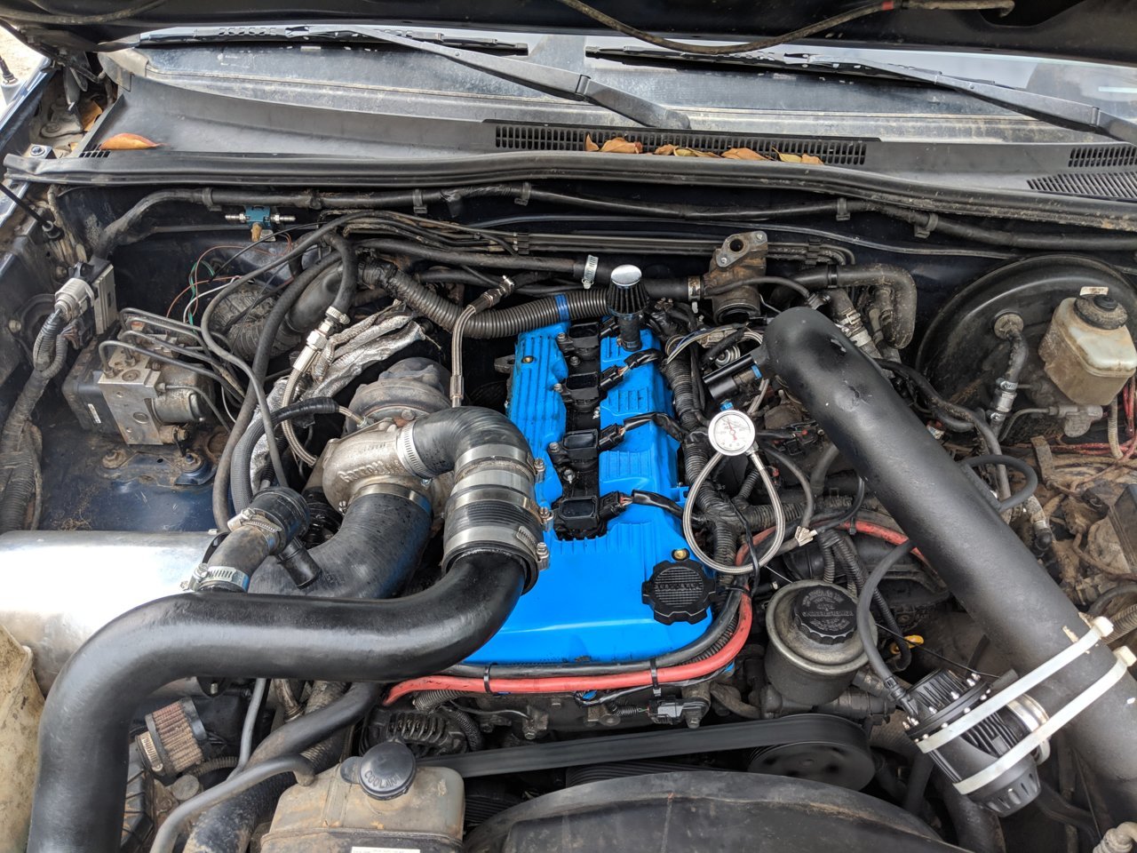

    Got a lot of stuff lol

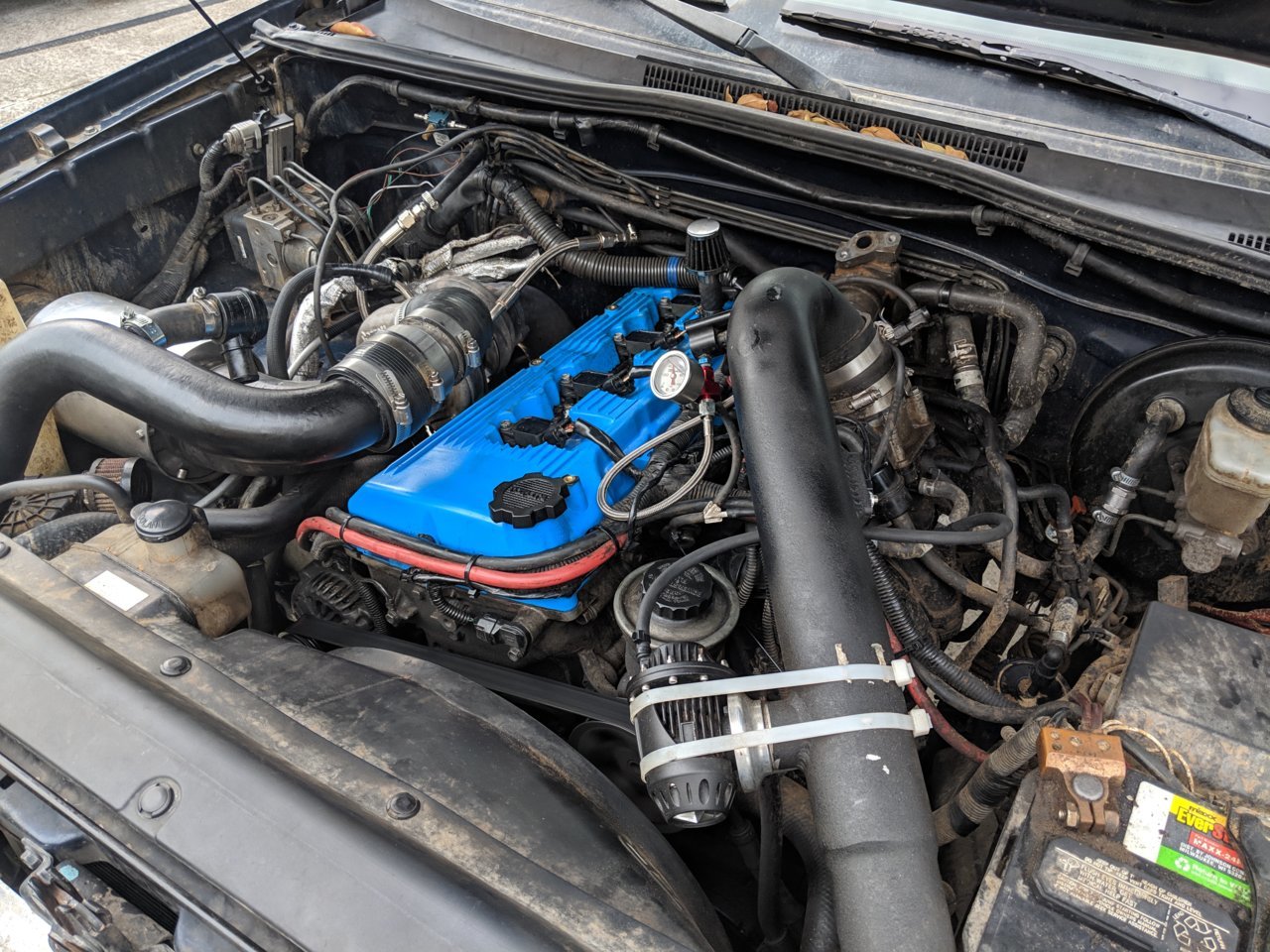

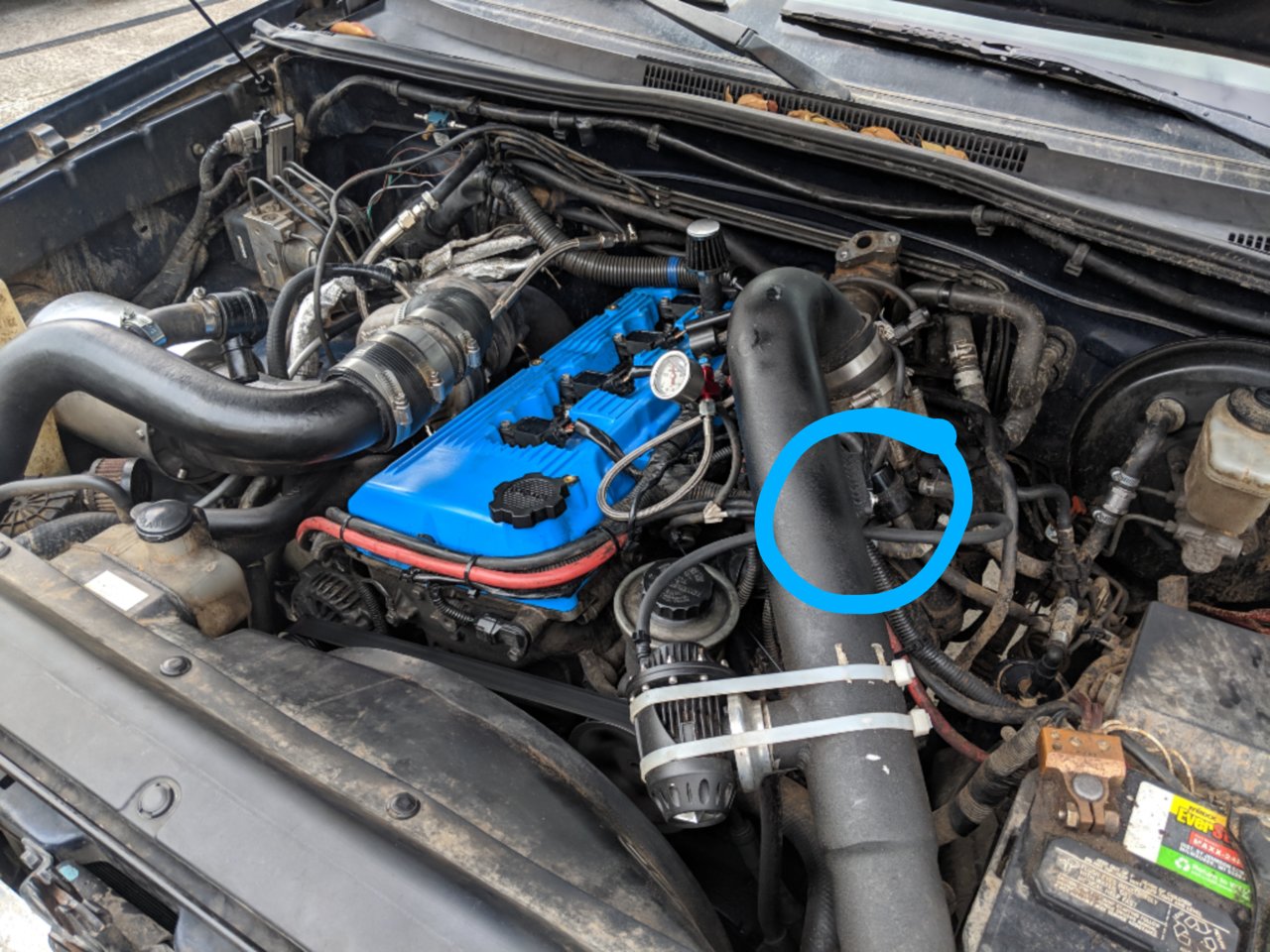

    I don't see the MAF sensor anywhere. Help us out.
    Next, is that plastic recirculation valve strictly being used as a plug or something? That can be a source of a leak.
    Why is your HKS BOV only held on with zip ties? That is a source of a vacuum leak, if the MAF is before that.

    Sorry the MAF is located in the blue circle.
    The recirculation valve is being used as a plug as I found it doesn't do anything until like 20psi
    The bov is held in with a c clip. I added the zip ties for alittle more assurance.
