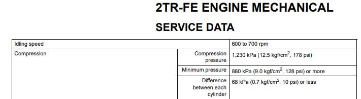

    Well the compression test went well 120 psi across the board. I won't be able to do a leak down until the weekend. I know the lifters are hydraulic so they don't require adjustment but is it possible that some of mine are clogged causing the ticking sound?

    If compression is good, is there still a reason to do a leak down?

    Is 120 psi pretty ok for the 2tr? My 1gr was between 190-210

    This, as I am curious what the normal spec for 2TR compression is as well? It is good however, that they are equal.
    Actually, yes it is. Sometimes the compression can be good due to oil thickness, but a leak down will prove that it is not holding compression properly. I ran across this exact scenario with one of my engines that had bad piston slap and scored cylinders. It was reading 180, but was having a lot of blow-by. The leak down would have shown. I opted for the bore-scope method. That is hard to see valves with though.
