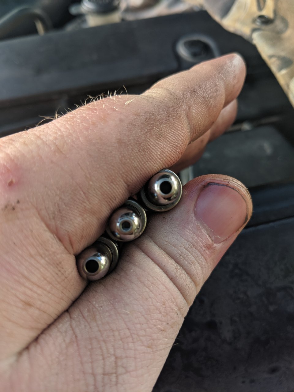

    Well the three I was able to pull yes they are getting new adjusters and rocker arms. I'm having issue with the bolts so I may take it in to get the rest swapped. Also my exhaust manifold has already cracked. I wouldn't advise anyone from buy them from China anymore. The trucks getting to the end of my wit lol

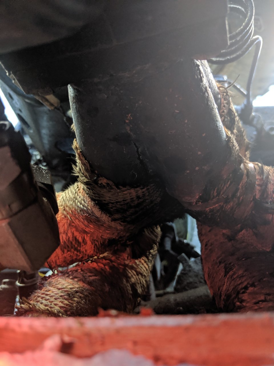

    Where did it crack? I haven't looked at mine since install

    Kind of a bad picture but the gooch

    Good to know, thank you
