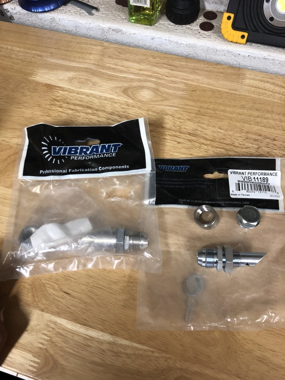

    I don't think things are as critical to vent at idle. You're not getting nearly as much blowby.

    You need the slash to protrude into the exhaust and it be angled. O2 bung will not work

    Yup. Must be angled. There are angled bungs available, if they weren't in that link.

    Should an intake return protrude in as well?

    Doesnt have to be. the main point of having it angled is to prevent exhaust gases from blowing up through the tube

    Doesn't have to be angled. As long as A: the pressure is less than or equal to 1 atm and B: the velocity of the air flow over the opening is greater than 0, Venturi effect will create a vacuum in the smaller tube, even at a 90* angle.

    Give it a try then but i wouldnt suggest it.
    Exhaust is pressurized so im not sure itd work still

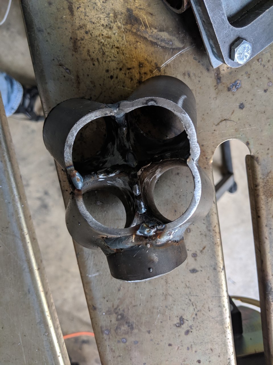

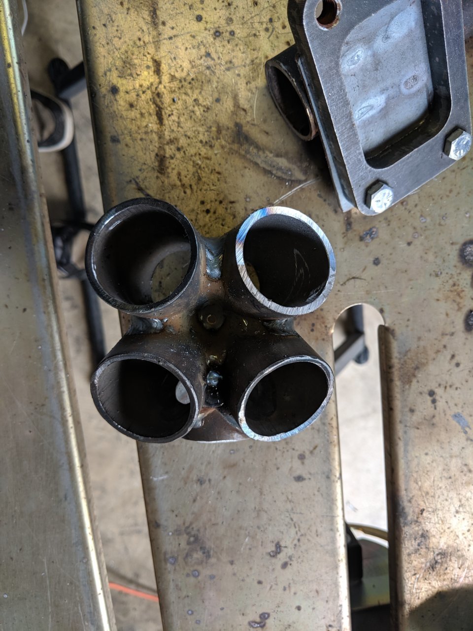

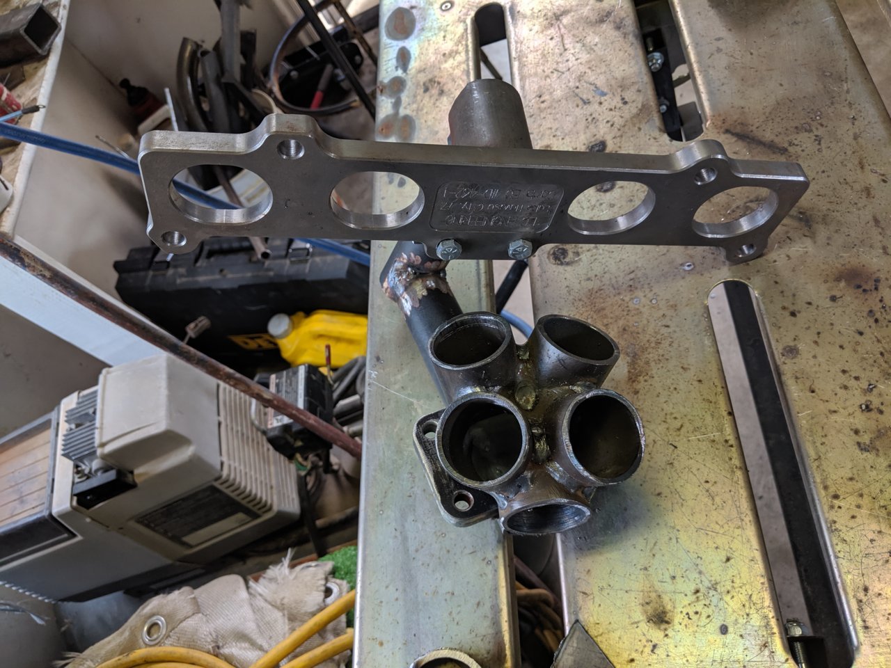

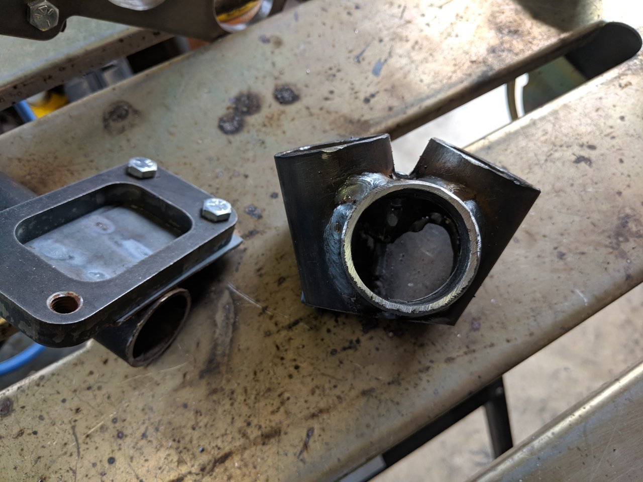

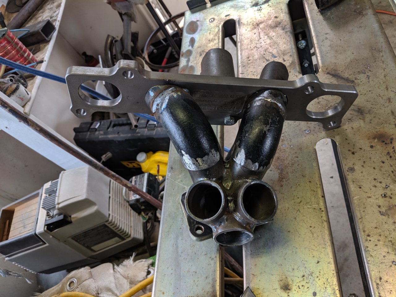

    Got a bit further on my 4 into 1 compact manifold.
    MVIMG_20190527_173809.jpg MVIMG_20190527_173913.jpg MVIMG_20190527_154956.jpg MVIMG_20190527_154942.jpg MVIMG_20190527_154929.jpg

    Why not just make a simple log manifold since you arent doing equal length?

    Most just the work to figure out how to make a 4 into 1 myself. I was originally on a log and it did fine for the last 4 years
