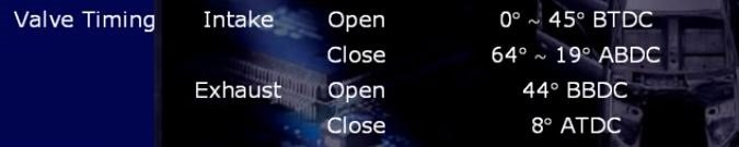

    So I found this for the 2TR valve timing
    That's showing a 45 degree swing, so does this mean there's 45 degrees of advance available for tuning on this solenoid?

  3. Jun 2, 2019 at 6:09 AM
    MrCrowntown
    MrCrowntown Well-Known Member
    Aug 7, 2016
    #193980
    2,350
    Alyn
    Ky
    06 Extended cab Prerunner 2.7
    Dirt King Mid travel with King 2.5 coilovers, Baja Kits chase SUA with 14in fox smoothies under custom hangars.
    If set to stock parameters on a stock cam, it might not be the best. But if you can get a turbo set of cams with minimal overlap, then it could be used more effectively. My mind always goes back to the 2jz vvti and how much boost that thing could manage, which makes me think people have just become complacent with information provided on the internet from other complacent people. Time for true development

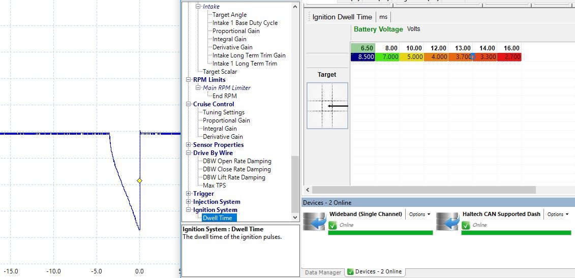

    So oscilloscope and current clamp came in today. Along with the power supply I already have, I now have COP dwell numbers thanks to Matt at Haltech.
    Saturation for 1GR & 2TR coils:
    Volts *dwell*
    6.5 *8.0*
    8 *5.0*
    10 *3.7*
    12 *2.9*
    13 *2.6*
    14 *2.4*
    16 *2.1*

    Holy smokes! This is invaluable!!! Exact same huh? Makes me wonder if which other Toyotas use those same coil packs and dwell times? Did Matt mention anything like that?
