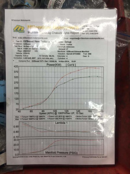

    In the land down under they making 550hp out of a 2tr. Fully forged. Stole this from a facebook page.

    Nearly 30 psi! On a GTX3582. McCrowntown! Get after it mayun!
