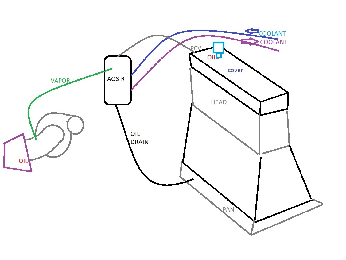

    I have a problem with my crankcase vent system, advice needed. I had oil come up through the head cover filter and now I’m seeing what appears to be oil at air filter.

    Turbos create a vacuum headache. For mine, all hoses attached between intake and valve cover/s have been removed and isolated. I imagine you did this, but am not sure. Then the valve cover/s are ran to a vent to atmosphere catch can.
    Piston ring blow by goes into crankcase and valve cover space. Through valve cover hose into catch can and vented. No boost air gets forced into the crankcase void preventing oil from blowing out where it shouldn't.
    Is that along your path, or do you have something more intriguing?

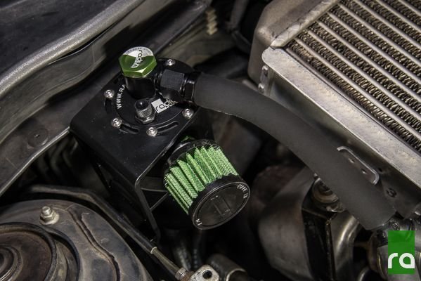

    Here's what I have going on, using an Air Oil Separator with Return (AOS-R)
    http://www.radiumauto.com/Universal-Air-Oil-Separator-Return-AOS-R-P890.aspx
    I noted the two places I have oil

    Looks like your seperator isn't quite doing its job. I don't think you want that oil going back to the pan. It's mixed with other stuff that isn't oil, water from condensation being one. Get rid of the pcv valve also. Back a few pages I posted a file about the ccv/pcv system. There was info in it about the pcv valve closing or restricting the air flow out of the valve cover and forcing it out the breather vent. This might be why you are seeing oil there. In that file the ideal setup was a catch can for each breather. I think both were routed back to the intake.

    The oil collects at the bottom until there's enough to flow over and down the drain, meanwhile the coolant going to/from the AOS-R heats the oil captured in the bottom, evaporating water and fuel etc to intake (or atmosphere)- supposedly it's clean oil going back in.

    I see pics of the line I have going to intake going to atmosphere

    So delete the PCV is what you're saying, unrestricted line from cover to AOS-R
