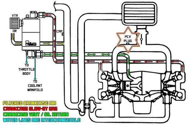

    The PCV plug in the picture is on the intake manifold, not the engine. The picture is a boxer engine, so that's the PCV port that they're using as the drain back to the engine. All the AOS systems I've looked at for a WRX replace the PCV valve with a straight through fitting.

    I’m confused haha. This whole setup doesn’t even make sense to me- if there’s crank pressure then I would think the input would be from the crank and the drain would be to cover, but it’s vice-versa. I have parts on order, I’ll know more next week.

    Looking at that image again, the flow arrows on the crank line shows flow in both directions

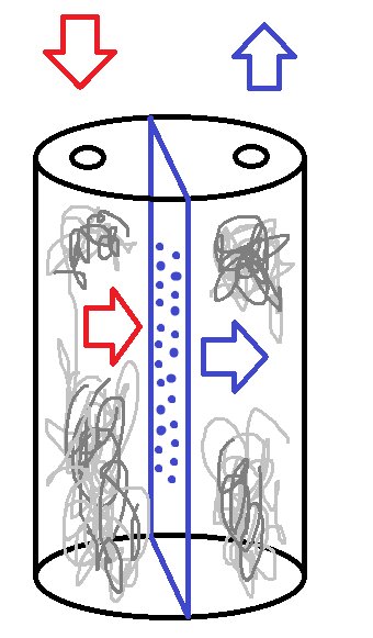

    Get a cheap one and pack it with stainless steal wool if you want cheap. If you can gain the access, use a thin sheet of metal to separate the in and out port to keep the air flow from going in and then directly out of the catch can. Let me dust off my MS Paint skills here.
    Get this one and you can even wrap the thin metal sheet around the 'baffle' and secure it with a hose clamp (what I'm planning on doing - I have a similar catch can).
    https://www.amazon.com/ESPEEDER-Uni...BBSEHN0J85QC706JVYWF&qid=1560343493&s=gateway
    Just make sure its perforated and the holes go up the entire way to allow continued flow as it fills up.

    So reading the "CCV Bible", the PCV closes during boost and crank pressure are expelled out the air inlet filter on top of the cover- this is where the oil is coming from.

    Right now I have the rear vent with a one way valve for "in" only and I'm running my PCV to the catch can then to pre-turbo but I'm modding that catch can (as illustrated above) to really clean the air so it doesn't deposit a bunch of grime and crap on the turbo blades.
