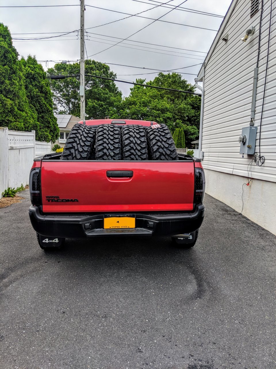

    Maxxis Buckshot II's in 265/75/16 will be going on tomorrow. Definitely excited to get some mud terrains on in time for summer/beach/offroading season!
    Simple Tire was having an awesome sale on these, and they've gotten good reviews from a few local people with Jeeps that have them. Less than $600 out the door for all 4!

    Holy smokes!!!! Those will fit as is?

    Yeah, 265/75 is the max you can run with no lift. The current tires are Hankook DynaPro ATM's in a 265/75. I removed the front mudflap, and trimmed a little bit of plastic from the fender liner since my wheels have a decent backspace and offset to them, so they'd rub at full lock in reverse (backing out of a tight parking spot usually).
    I'll see how these wear, but I'm excited to really see how they make the truck look and perform on our property upstate NY.

  13. Jun 14, 2019 at 5:19 AM

    I think people run 255/85 on stock suspension... I am at the 1.75 notch on 5100 but seems like there are people in the 255 thread on stock setups

    Just reiterating, stock suspension vs 3" lift will clear the same tire. Nothing changed with how much the tire can articulate up into the wheel well. If you never "flex" the suspension you can get away with bigger tires with a lift but once the curbs get bigger you'll rub.
