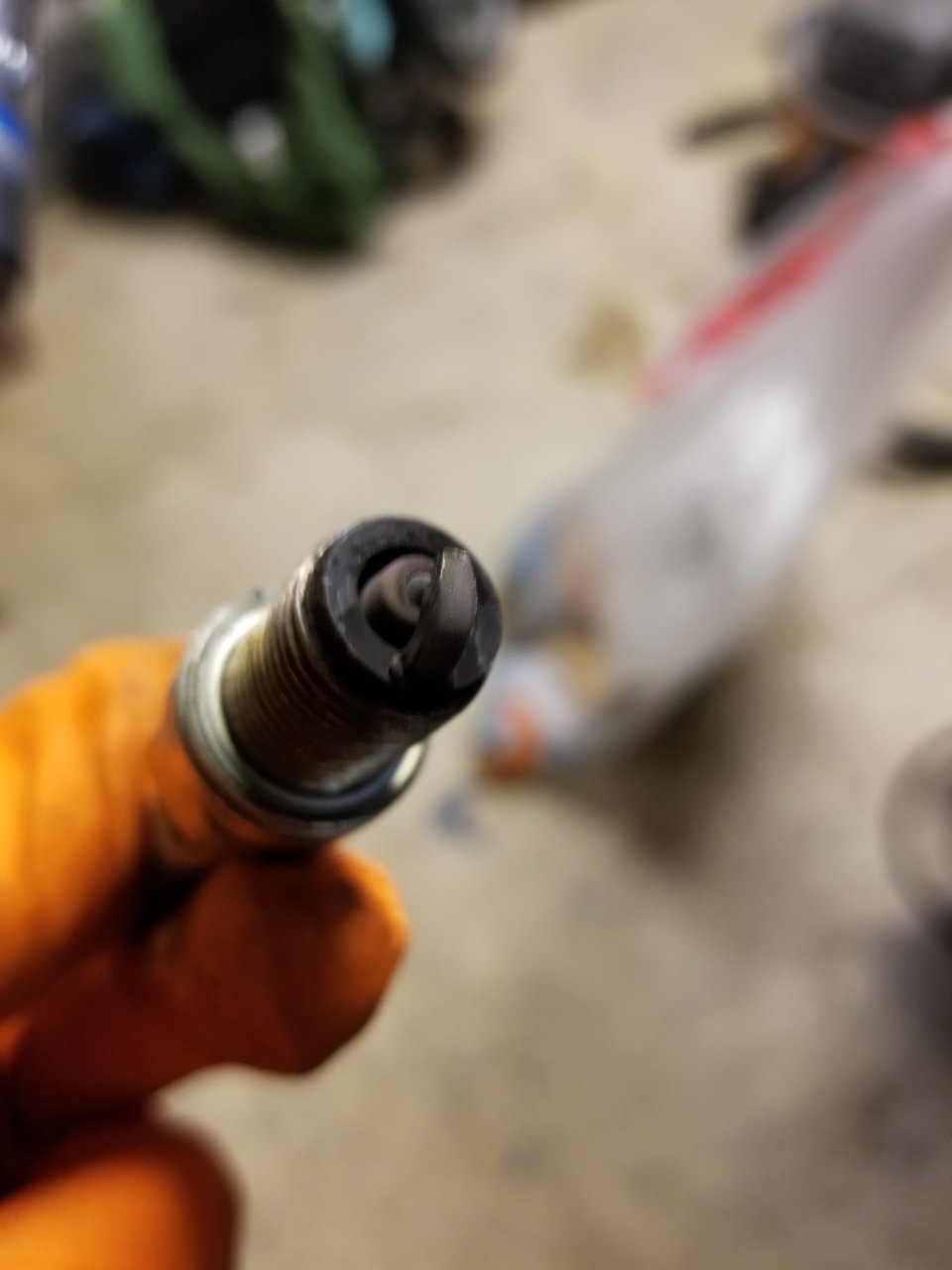

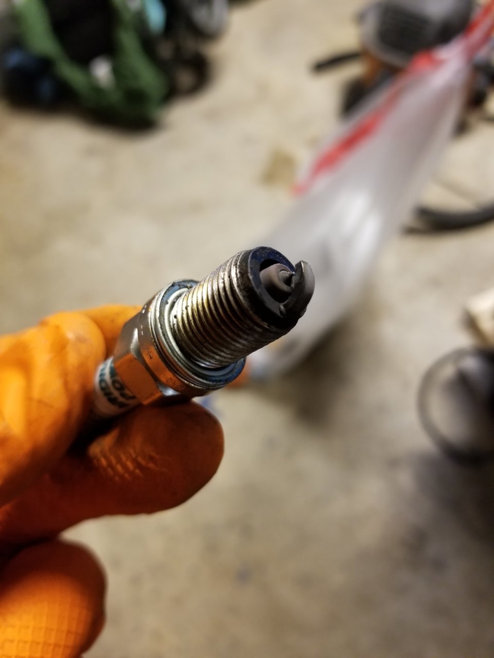

    IK22 is too cold for the 5VZ, at least at my boost levels. My MPGs were fantastically horrible so I pulled them and sure enough too cold. Replaced with IK20s.

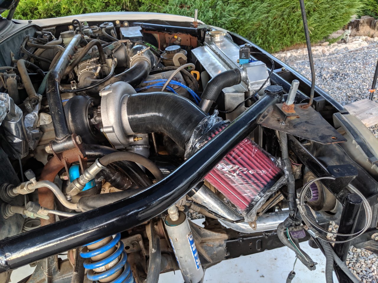

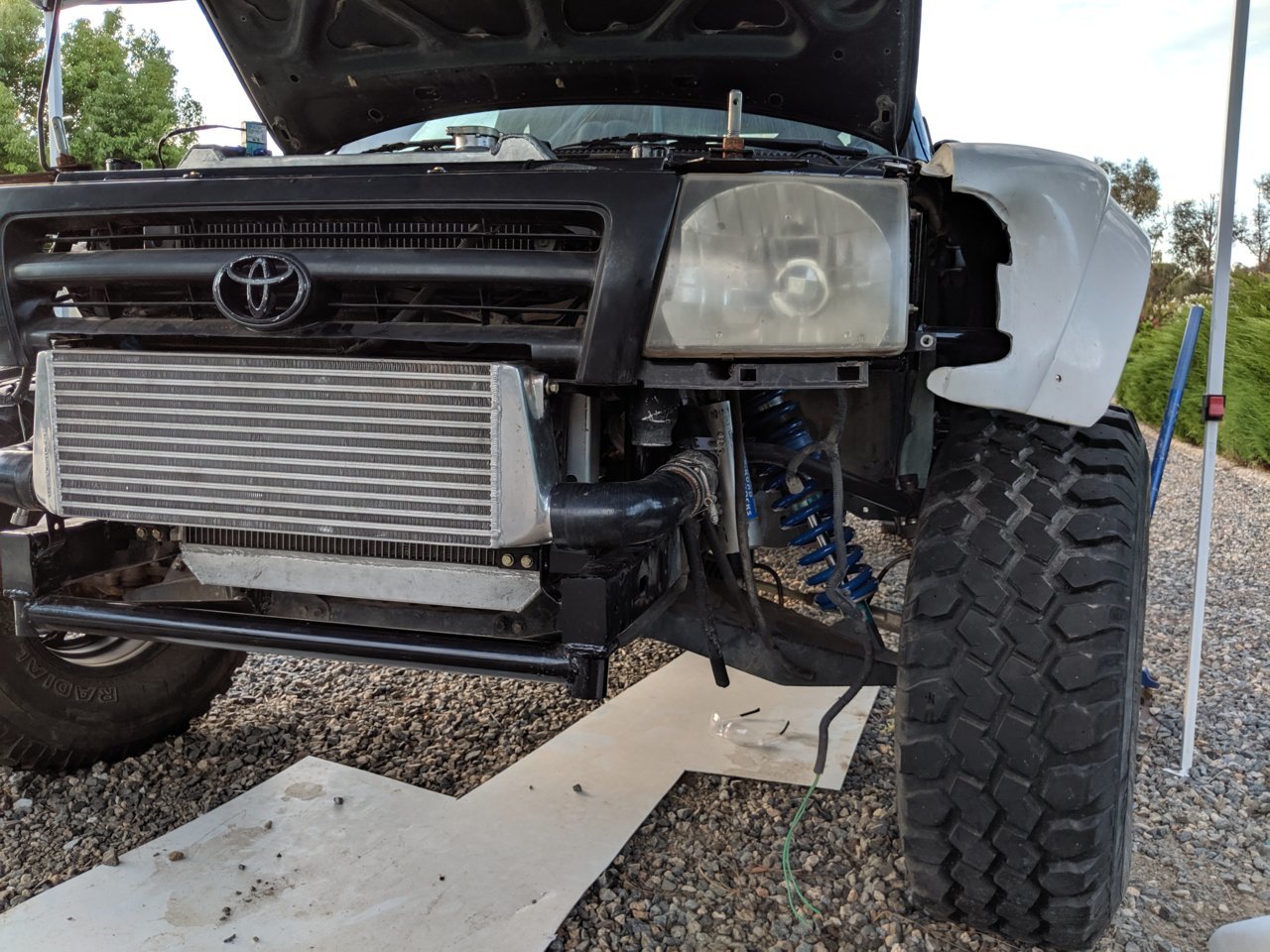

    Figured out charge pipes and intake. Off to doing a downpipe next.

    That's really coming together nicely. I like the lowered intercooler placement as well.
    Vacuum lines and oil lines, and it's ready for start-up!

    Be nice to have it running in a few weeks. Depends if I can nail out that downpipe next weekend. I can't rush my fab work or I just start making a whole bunch of mistakes. Had to move the intercooler to this position. The charge pipes tucked in tighter to the frame. Hopefully month of September is working out the bugs and tuning.

    air flow is gonna be an issue with that filter sock you got there...
