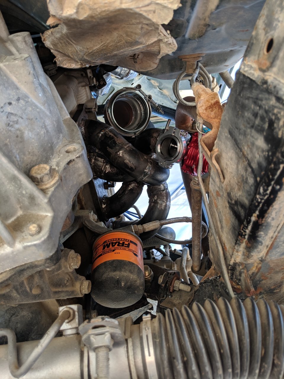

    Tiny start to the downpipe. Isn't much room to get your hands in there now.

    Ahh the in and out process that begins now.

    Have that v-band flange clamped to the turbine housing, to dissipate heat, prevent warpage, and only weld a small section at a time. Let it cool, then do another small portion. Warped v-bands are the worst most frustrating problems.

    All flanges here all are now clamped / bolted down now.
