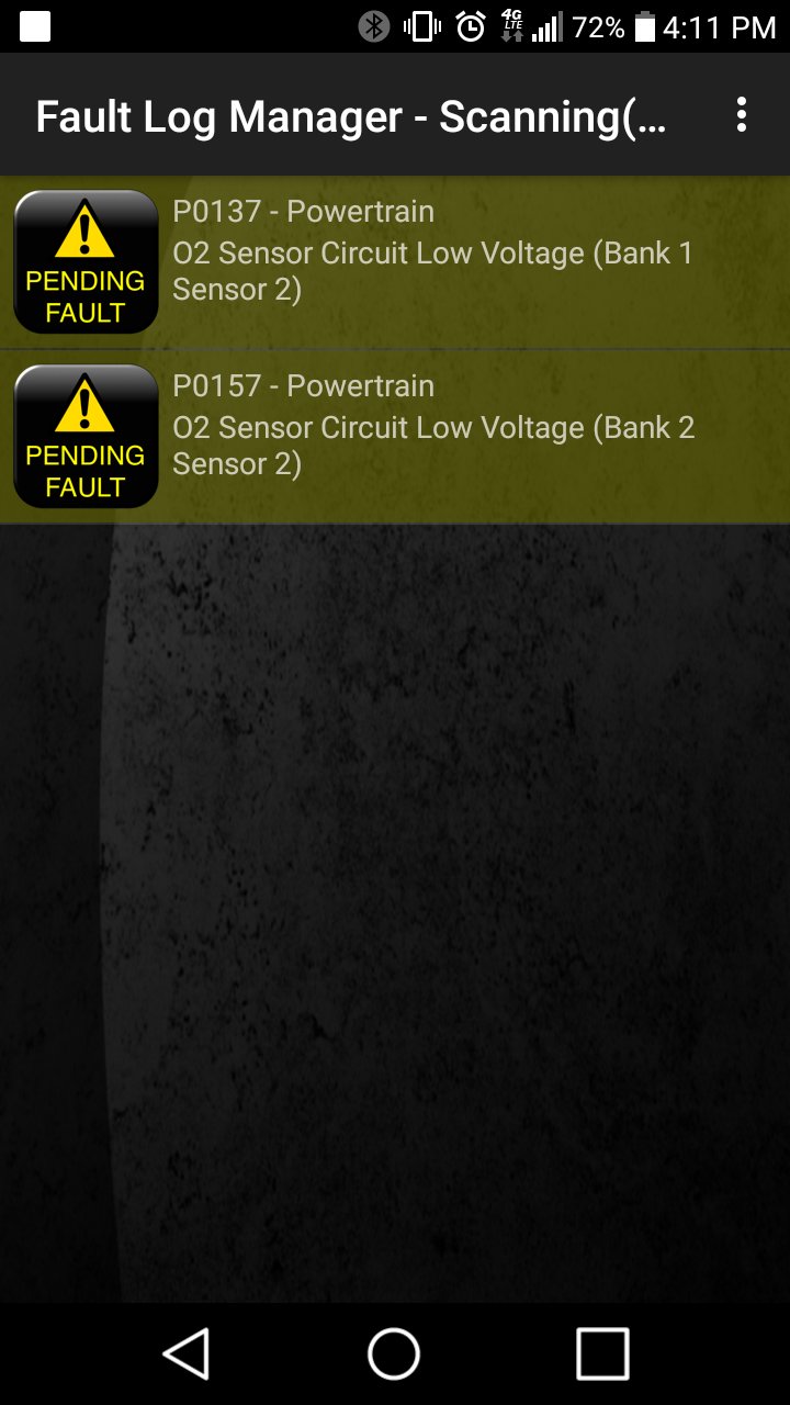

    Could be worse... Also my ltft 1 and 2 ate 8% apart 2 is ~8% richer... Any thoughts? Could these pending codes cause somethin like that

    Sensor 2 is the post cat o2. The pre cat sensors (sensor 1) control fueling, so they shouldn't have too big of an effect.

    Your pre sensor will give feedback to the ECU for fuel trim so yeah that will affect AFRs.
    Or are those both down stream sensors?

    Sensor 2 is the downstream sensor. They're just for cat function monitoring.

    Yeah I was just wondering if there was an issue that could cause the downstream sensors to throw codes that may also effect fuel trim like... If you run out of oil, you have no oil pressure AND your motor locks up...
