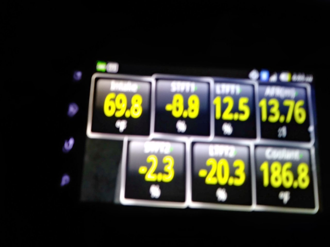

    Pulling a boat... How do I tune this out?
    Sorry for the blur

    Very certain hasn't tuned the higher load cells. Just pull fuel from that rpm / boost cell.

    But ltft 1 is 12.5 and ltft 2 is -20.5 will it not just shift the problem to bank 1 if I start pulling fuel?

    Is your primary and secondary tables the same?

    Nah that seems like something someone who knows what they are doing would do... Would it be flipping between primary and secondary?

    I believe primary controls bank 1 and secondary controls bank 2

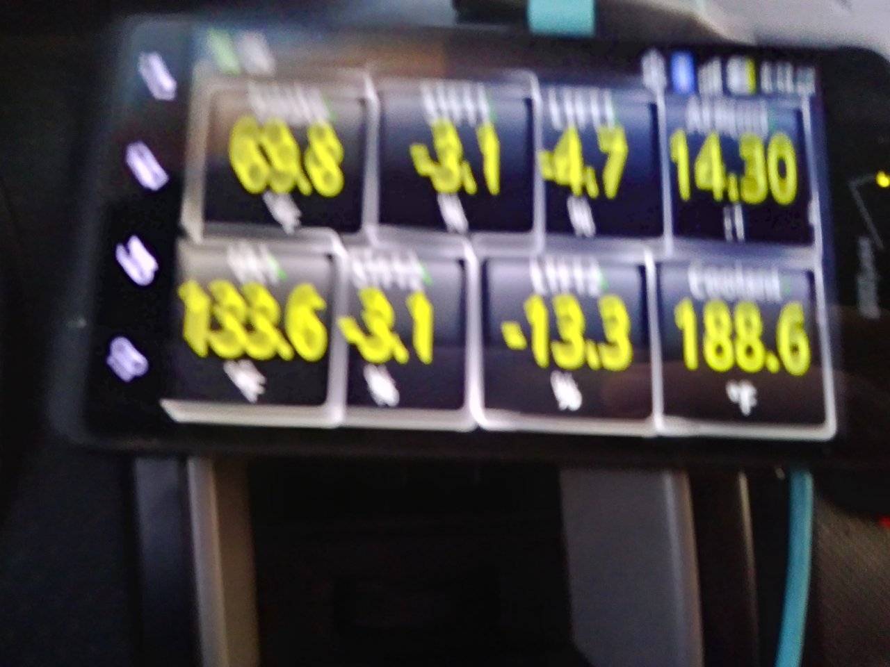

    Well mike, you may have been on to something with that "primary secondary" junk... Also I cannot make changes to my secondary fuel table while I am connected to the ecu, and copy paste is nonexistent for some reason; I had to disconnect, manually change all the zones in secondary, reload it to the ecu and it seems quite a bit better now... We shall see how things go now and also :cheers: .... Disclaimer: if this doesnt really fix the problem, I'm sure I still owe you a beer...

    How are your fuel trims now?

    Idle trims are better... They were still a bit wonky 0-10 inhg (mmhg? Too hot today) I just pulled more fuel across the entire secondary because all the trims were in the neg so I had some wiggle room...
