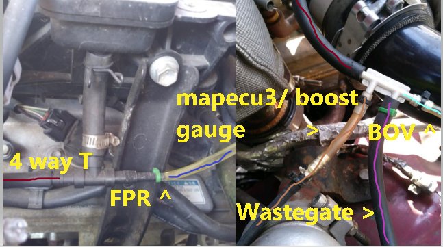

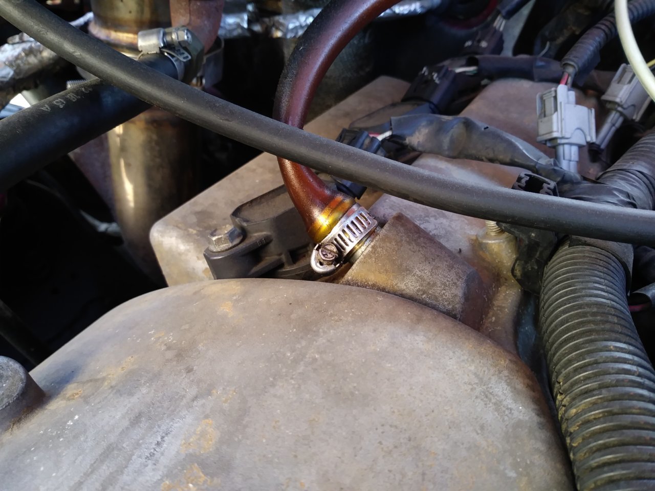

    That left picture says 4 way T. Looks like a 3 way. Is it a three way or really a 4?
    The hose connected to the PVC valve, on the valve cover. Where does it go?
    What about the hose on the passenger valve cover?
  10. Sep 7, 2019 at 3:34 PM
    yota243
    yota243 Well-Known Member
    Aug 22, 2012
    #85267
    21,641
    E.J.
    north Alabama
    turbo 05 prerunner trd off road DC
    Bw s256 turbo with 3 in glass pack dumped pre axle raptor liner bed and top rails and fenderflares and rocker panels. Hunter side steps. Plasti-dipped upper fenders and emblems. satin black spray paint here and there inside and out. 5100's set to 1.75" up front . C channel front bumper. Maxxis bighorn 255/85/16

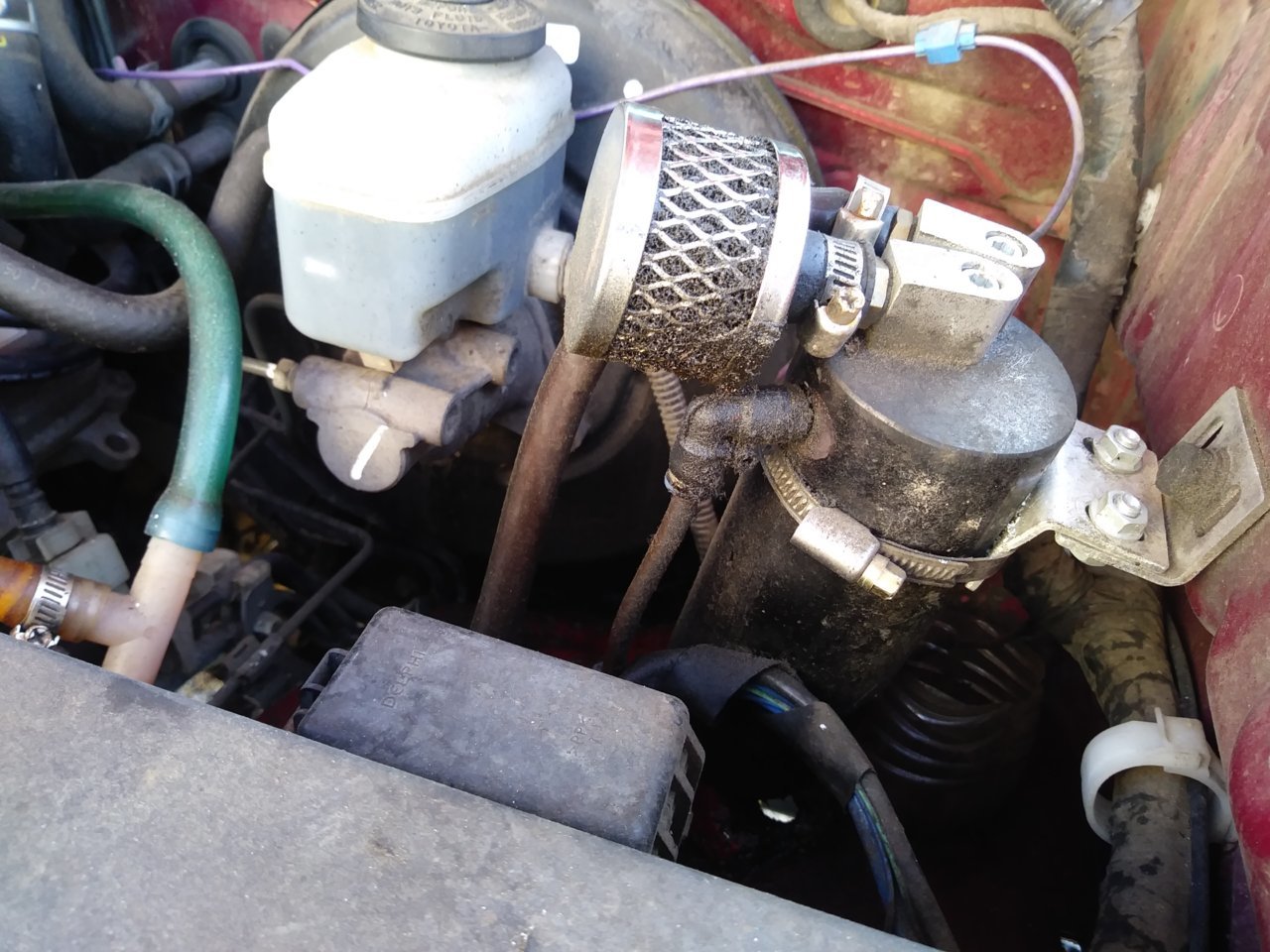

    Pcv is routed to a catch can... The left pic is where vacuum is sources and that "4 way" is red and continues to the right pic in red to that 4 way

    Take some pictures of the catch can hose routing and the passenger valve cover hose routing as well, please.
  12. Sep 8, 2019 at 6:47 AM
    yota243
    Aug 22, 2012
    #85267
    21,641
    E.J.
    north Alabama

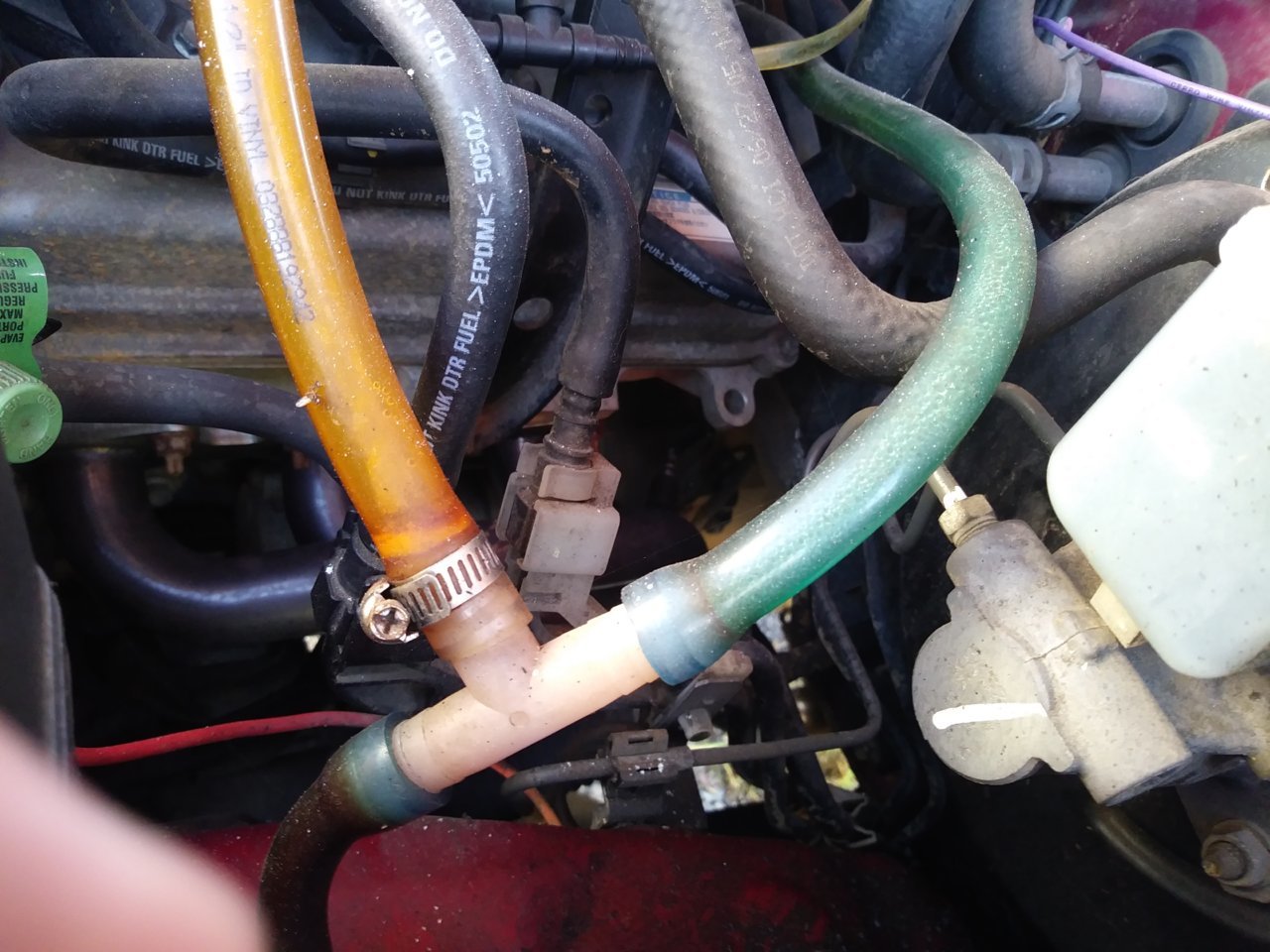

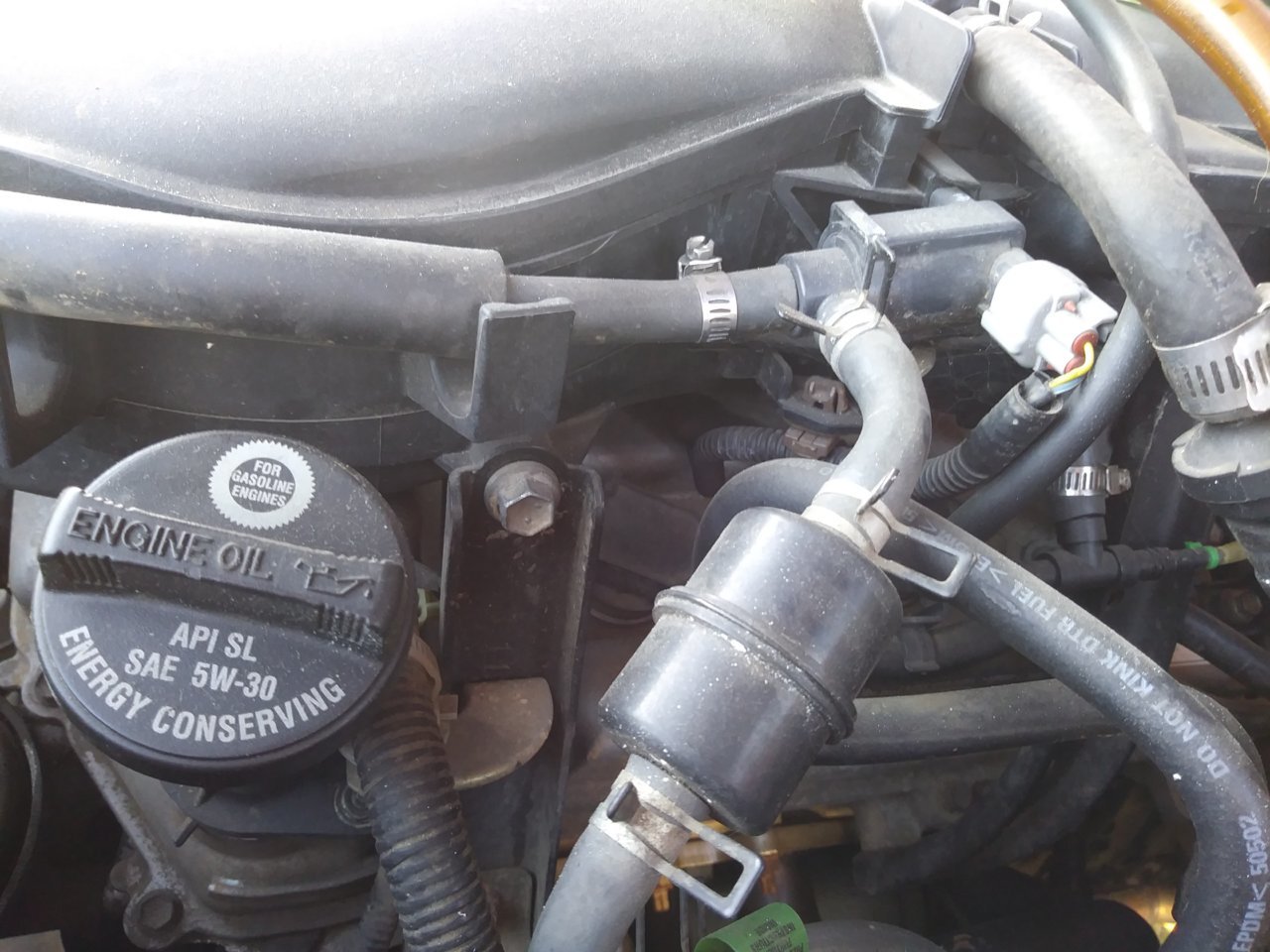

    Vent to atm. Each side t in and go to can
