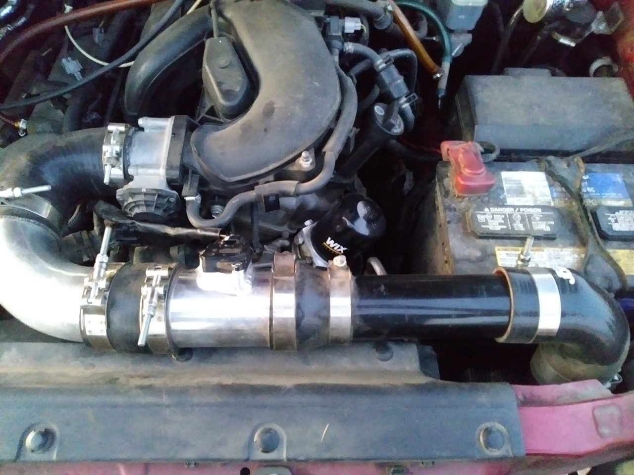

    20190908_181855.jpg The guy that helped me fab mine up has the boost

    Well I thought having ~12" of straight pipe going to the maf would have reduce turbulence a good bit.
    What are you saying now about routing the evap? Mine is probably ok?

    That change in diameter right before the MAF, without a straightener, may contribute to MAF turbulence related issues. Seen it before. Been datalogged a lot on XRU.
    You can try clocking MAF section in a few different positions and then see if the readings improve. Try to find the sweet spot.

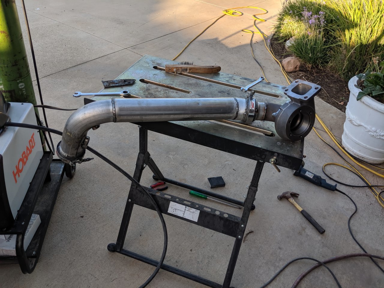

    Downpipe getting close. This smart guy bolted up all his flanges before welding.

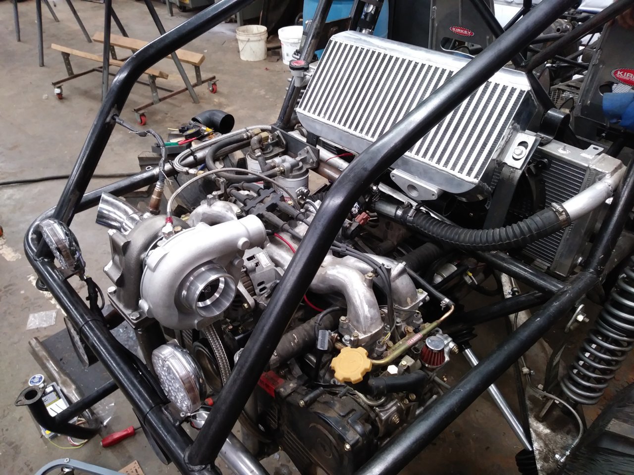

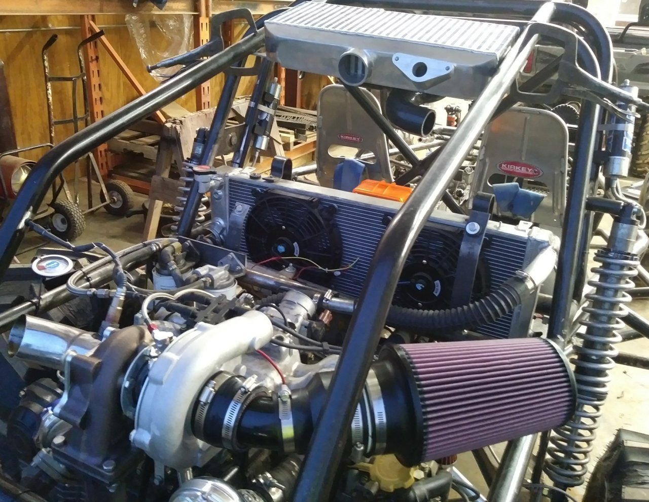

    Bigger return line in and all the oil is blown out of the pipes...
    IC relocated
    Torspd and MadTaco461 like this.

    Haha that little thing looks fun

    He said it was like 1700 lbs with him in it and it should be north of 250 hp soon :burnrubber:
