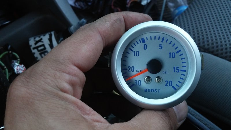

    Finally t-d into my lines and hooked up my bov and my boost gauge, thought i had a little leak in my lines (and i may) but it go to 0 and didnt get any higher on my 1st straight away, but i hit about 2 psi on my 2nd straight away at just past 1/2 throttle or so... I was gettin worried cuz i was at almost 3k rpm and i just sat there like "dang that sucks" then lag haha VROOOOOOM It jumped to 4500 in a hurry and i was doin 80 before i knew it. I have got to get them new injectors in a get a tune this thing is gonna be a beast at 7.5. I need to figure out where/how to mount this gauge, i bought a universal and piller mount for 2 gauges and was gonna be for boost and afr, but i may put it in the blank below the air vent (2wd solutions) and just use the torque app for afrs since ill have it up for temps anyway and its pretty much free and no extra work20170515_194158.jpg

    Is it the stock ecm? Is your BOV recirculated?

    I assume u are talkin to me, i have a mapecu3 installed but just runnin a stock tune and bov vents to atm

    ahem...http://urdusa.com/store/Electronics...uge-Mount,-Tacoma-2005-2015/product_info.html
