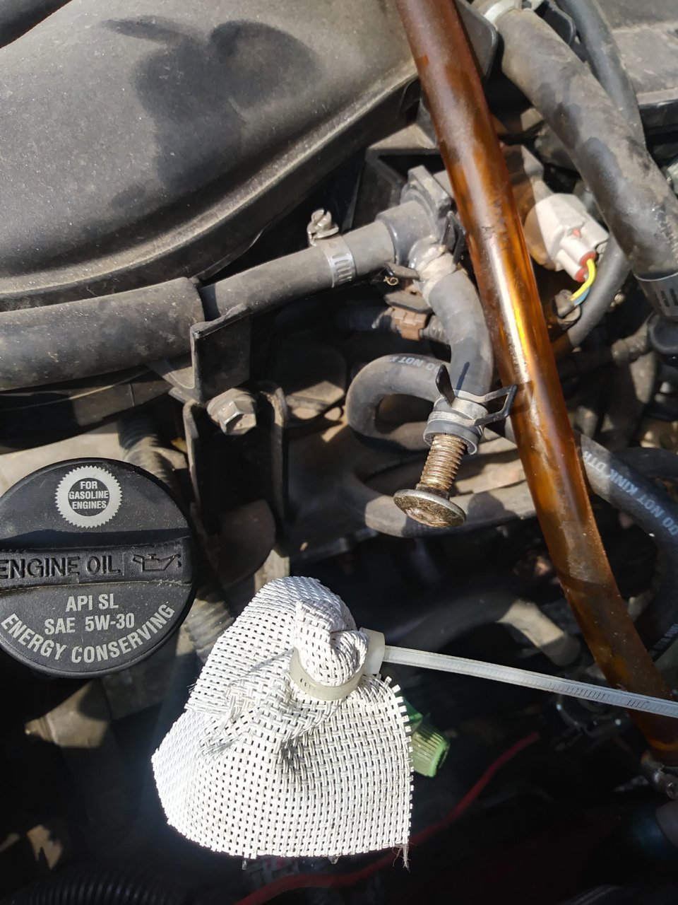

    Cap it at the solenoid.

    And then let the end from the tank open to vent? I assume some pressure builds in there...

    Annnndddddd......???

    Eh... Seems about the same... Ive only drove like 2 miles though

    I did get some boost in those 2 miles of course...:burnrubber:
    Ps engine was warm

    If at all else then it could just be the tune. Do some more driving and see.

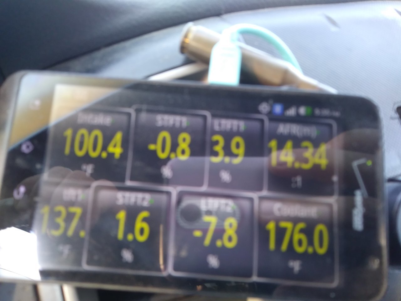

    Numbers are better... Still need to pull a little fuel when I accelerate close loop over 2k rpm... Bank 1 and 2 are still between 9-12 apart so I'm just trying to split the difference to keep it inside of 10/-10
    And yes that is 100° F...
