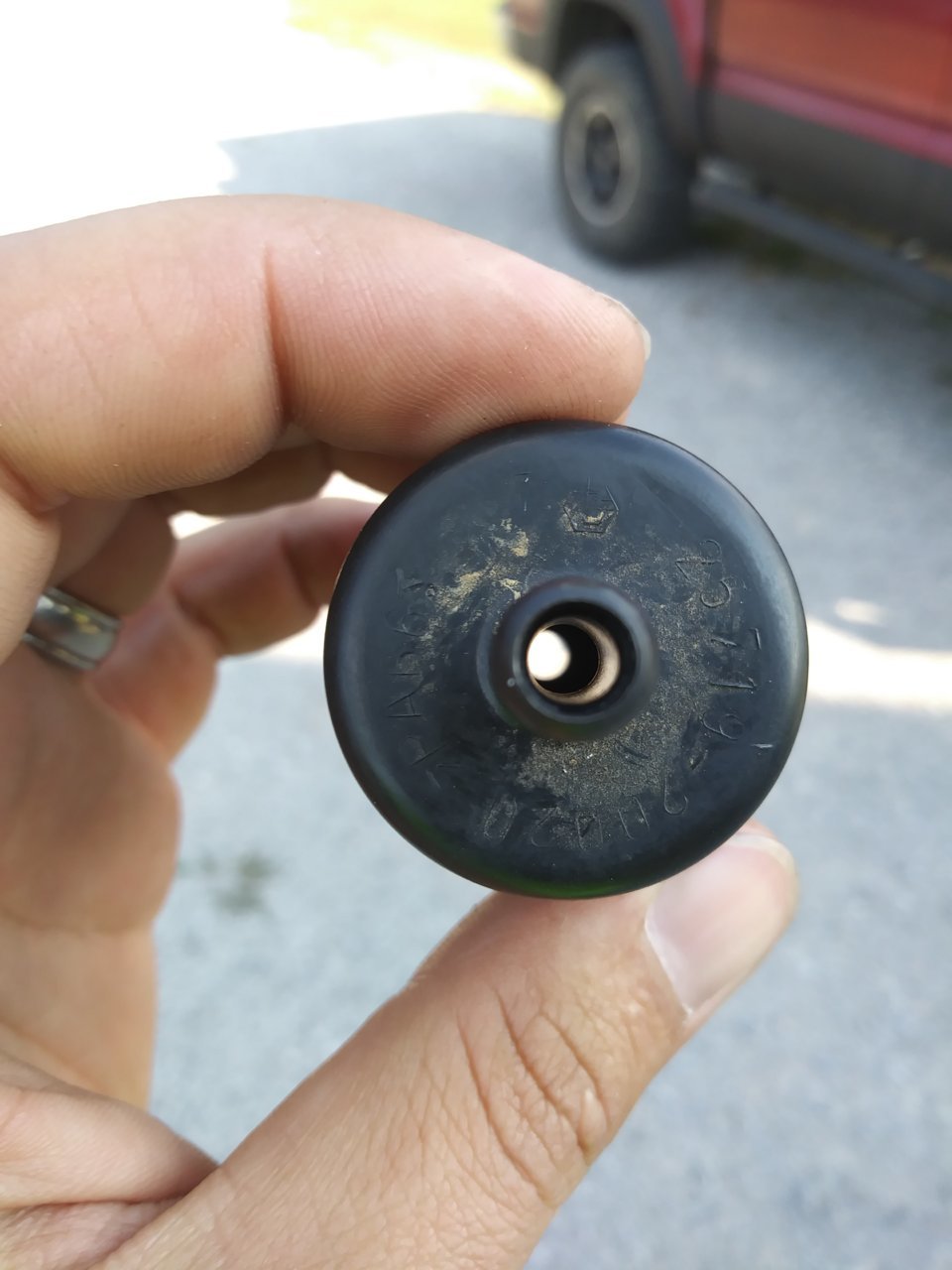

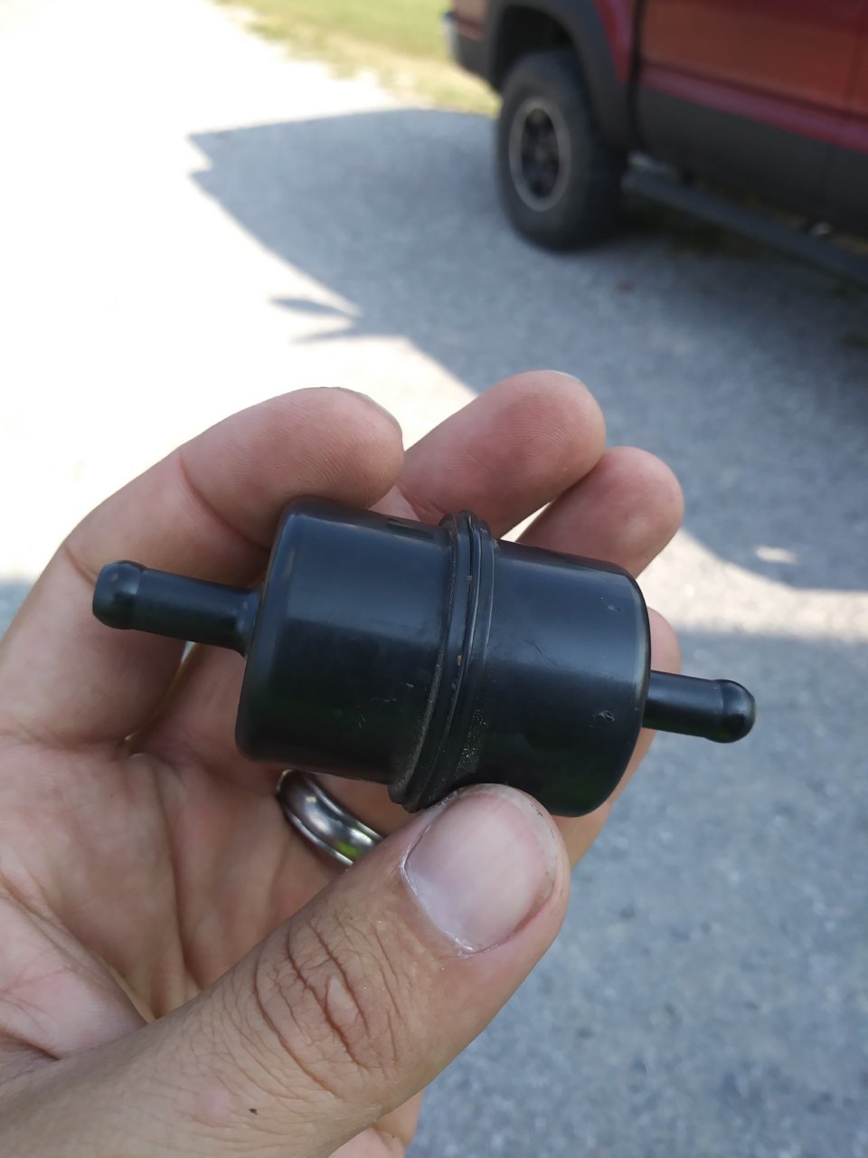

    And what the heck is this? I thought it was a check valve or filter or something but there is nothing in there

    It's gone from mine. Lol

    Was it once more than just a fancy short straw? Also I took my valve thing off today and if it is stuck, it is stuck shut cuz I couldn't blow through it either way... I think it just sucks air through my fuel tank and it comes from the same place that fuel runs out when I fill all the way up... One day ill tank that apart and try and put it back together correctly.

    Some vehicles with the 2TR in other parts of the world have a fuel filter and the evap canister under the hood, right where the fuel hard lines end. I've thought of retrofitting that fuel filter and if my evap goes out (when it goes out) I'll retrofit that bastard too

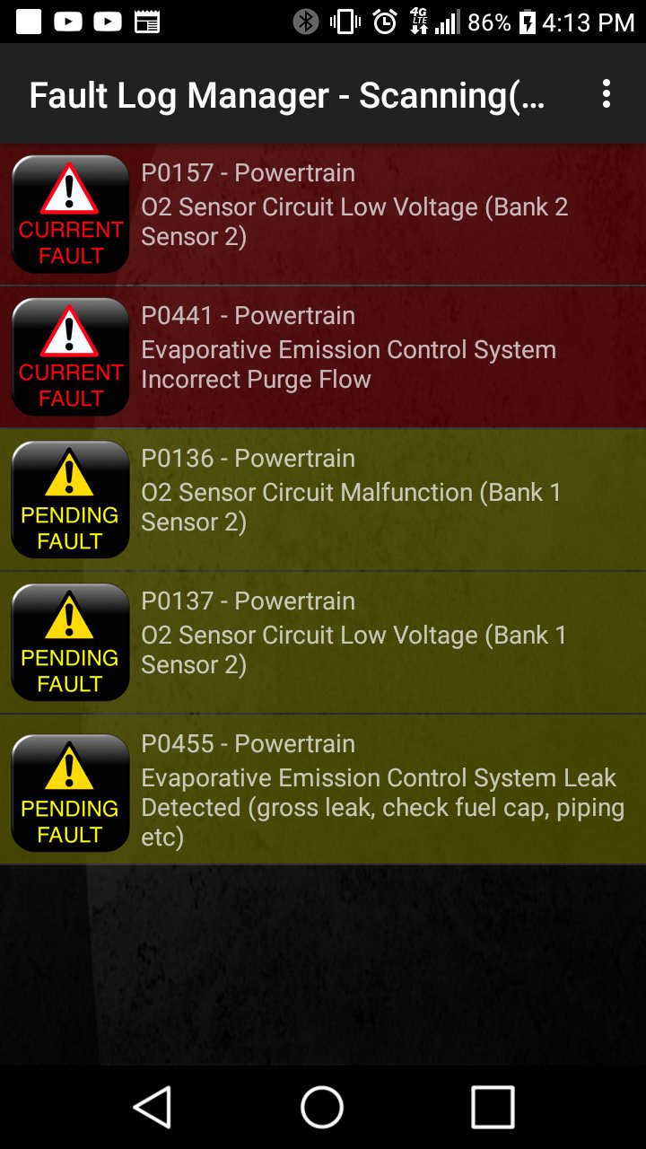

    Got her back to where she was a year ago... So... Much... Fuel haha... Also I think I found my vacuum issue. Where I had everything source was connected with the factory (crap) spring clamp thing; I replaced with a hose clamp and I think this is also why I could only hit 5 psi on a 7 psi spring

    So all in all, there was a vacuum leak. Now that it is fixed your fuel trims are better, and the truck runs much better. Correct?
    Have you checked all of your other vacuum hose connections?

    The trims are within 7-10 now so much better and I double checked my other connections and added a zip tie here and here
