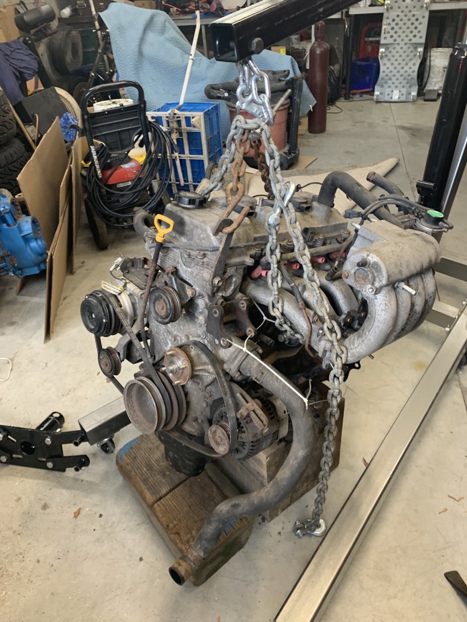

  19. Oct 13, 2019 at 11:08 AM
    Jcyr
    Jcyr Midnightthetaco
    Mar 16, 2017
    #213447
    3,280
    Jack
    North east
    3RZ 04 4x4 black ext cab
    2.5" lift king/total chaos Skids sliders rear tire swing
    Looky at what i picked up
  20. Oct 13, 2019 at 12:11 PM
    Torspd
    Torspd Tor-nication
    Sep 18, 2009
    #22958
    26,429
    Tor
    The Great America!
    MMVI 4.4L 4x4 Access Cab
    Torspd Custom Turbo kit [] Borg Warner 9180EFR Turbo [] Haltech Elite 2500 [] TiAL Q BOV [] TiAL V44 Wastegate @ 15psi [] CP Pistons [] CP Carrillo Rods [] ARP Head studs [] ARP Main Studs [] ARP Header - Head Studs [] Ported Heads w/ 1mm oversized valves intake/exhaust [] Brian Crower Forged Stroker Crank [] Darton M.I.D. Sleeved Block [] Kelford Camshafts [] Torspd 160* T-stat mod [] APR Large Fuel Rail [] Walbro 460 LPH E85 Fuel Pump [] FueLab FPR [] APR T56 Conversion Kit [] KP RACING Built T56 [] McLeod Racing Custom Twin Disk Clutch [] One Piece Aluminum Driveshaft [] MGW Shifter [] Custom lowering kit [] Ohlins Front Coilovers [] QA1rear shocks [] Custom Ron Davis Radiator [] Dual SPAL Electric Fans []
    Buiding that one up???
    Jcyr likes this.
