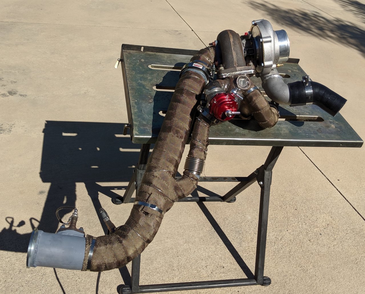

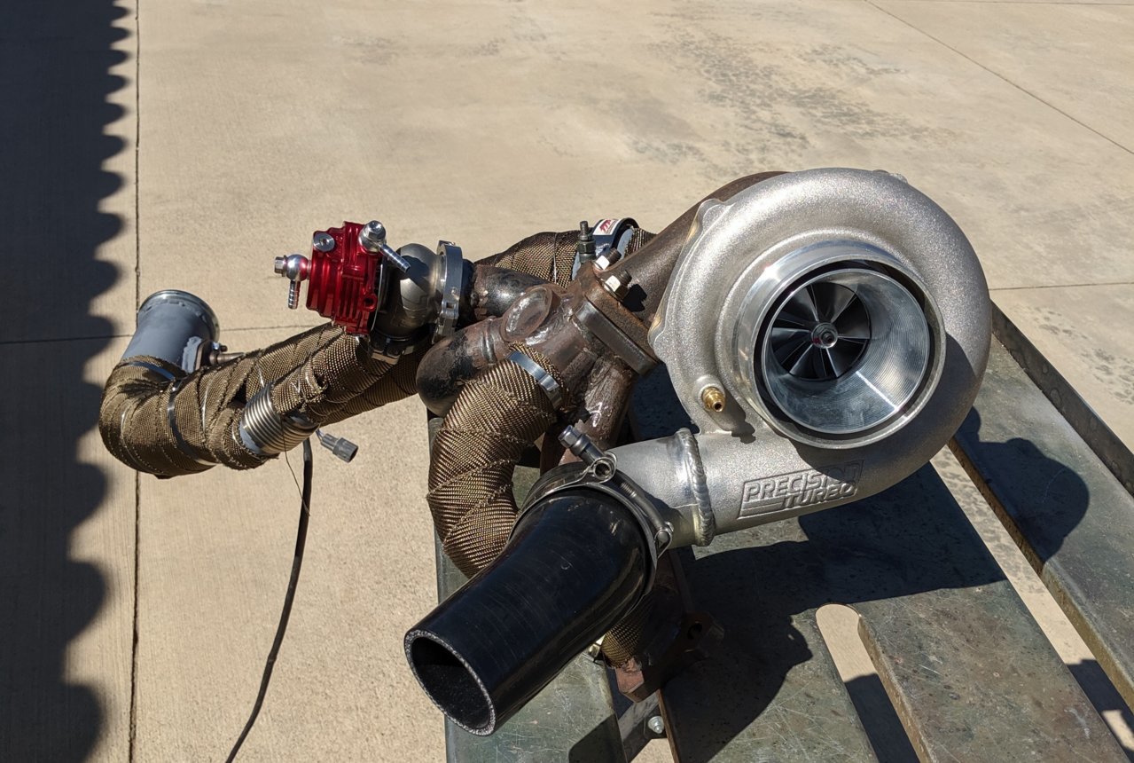

    Did a quick bolt together before stuffing into the truck. An efr would of been easier. Ran into oil line issue. Who would have thought precision uses imperial threads for oil feed and drain while the exhaust is metric.

    That is Precision for or you. A little bit of an oddball.

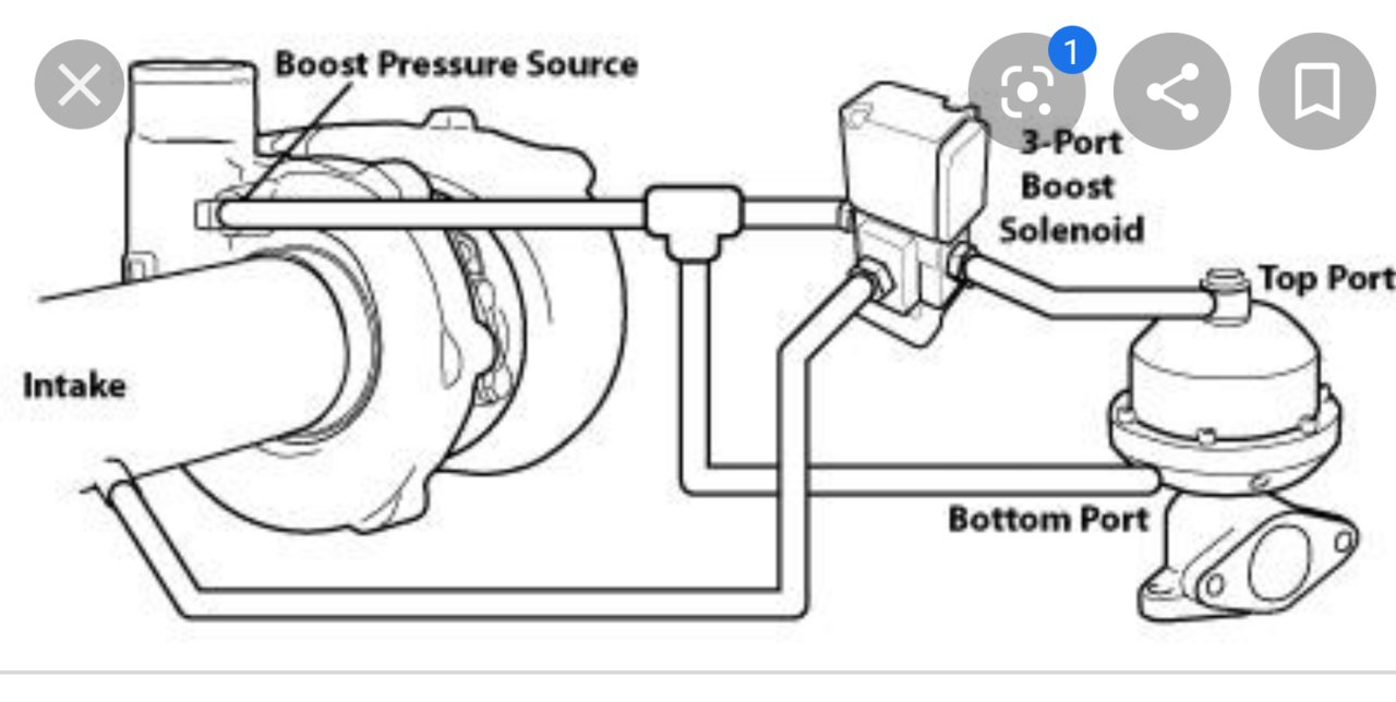

    That's a paranoia in physical form. When I did my first kit I melted a whole bunch of stuff.
    It should be easy I'm hoping. Don't think I forgot anything. You using a 3 port or 4 port solenoid?

    3 port.

    Pretty much. Except the hose going to the intake is just vented.

    Is that setup negated by using a self contained system like the BW EFR series?

    Thanks, I picked up a T fitting today to switch over to this style.
    Yeah internal wastegate and external wastegate are different on how you set up the hose routing. On occasion I'll see someone set their external gate where the top port will be an atmosphere vent and interrupts the lower port to raise boost.
