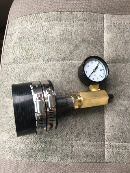

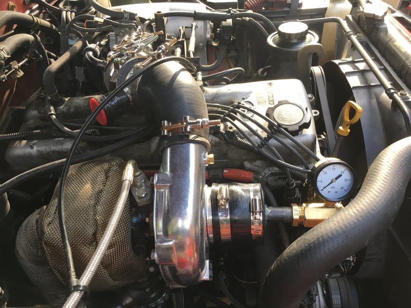

    image.jpg image.jpg Here's the leak checker installed found a major leak at this vacuum tube that I welded

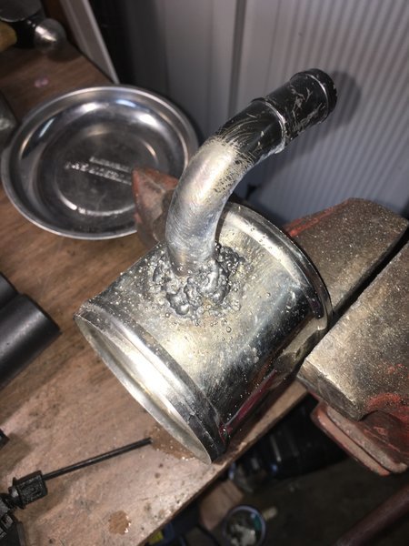

    Anyone have any suggestions how I can see all this welding it doesn't seem to be sealing it image.jpg

    Grind it down a bit, try again. Repeat until it holds pressure?

    The weld is too porous. Grind down the weld, and I'm sure you'll see all the voids/holes. Grind it down and put a weld on there that doesn't look like a pot of boiling water.

    This will be the easiest thing to do. You could seal all the ends and add some air and spray some soapy water but u should just start at 0
