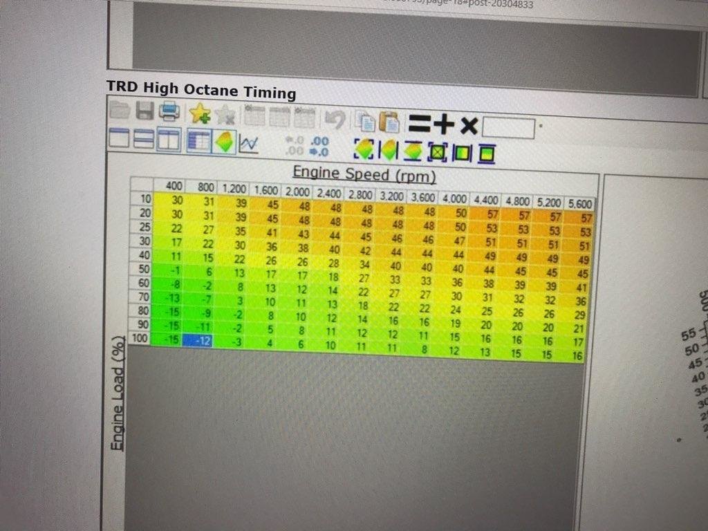

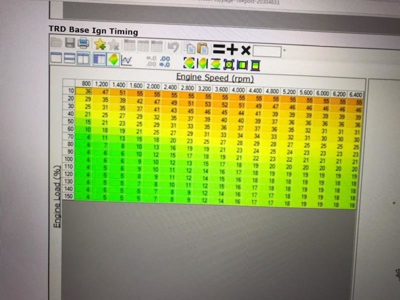

    So what’s the most timing you guys are running on the boosted 1gr?

    Depends on where in the VE map that you are referring to? I have the TRD boosted maps of you are curious?

    From what I can see in the TRD tune in the base spark map the max is 19-20. I know in my logs I've seen 16-17 degrees at most during a WOT run.
