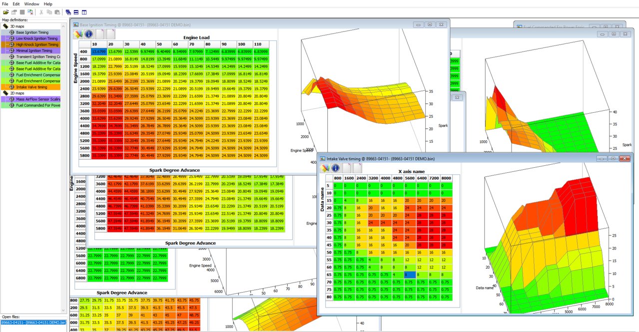

    What's the y-axis on the intake valve timing map?
    And showing my tuning noobness, I'm trying to understand "engine load" because my Spark Degree Advance table is RPM v PSI

    They’re setup with Air Load (Calculated Load) vs RPM

    Ah ok, so MAF readings. I deleted my MAF, no way to correlate those to MAP readings I guess.

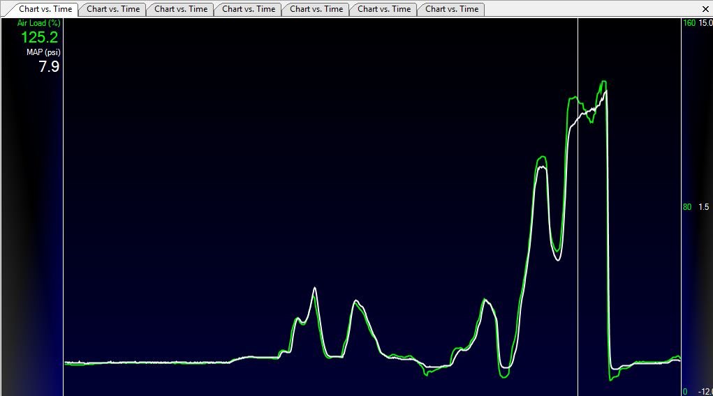

    Not specifically just MAF. Calculated Load = (Current Airflow / Peak Airflow @ Sea Level) * (Baro @ Sea Level / Baro) * 100%
    I'll post up some data for you of Air Load vs Boost from a 2.3" Pullied S/C 1GR. One sec.

    Should of kept the MAF lol
