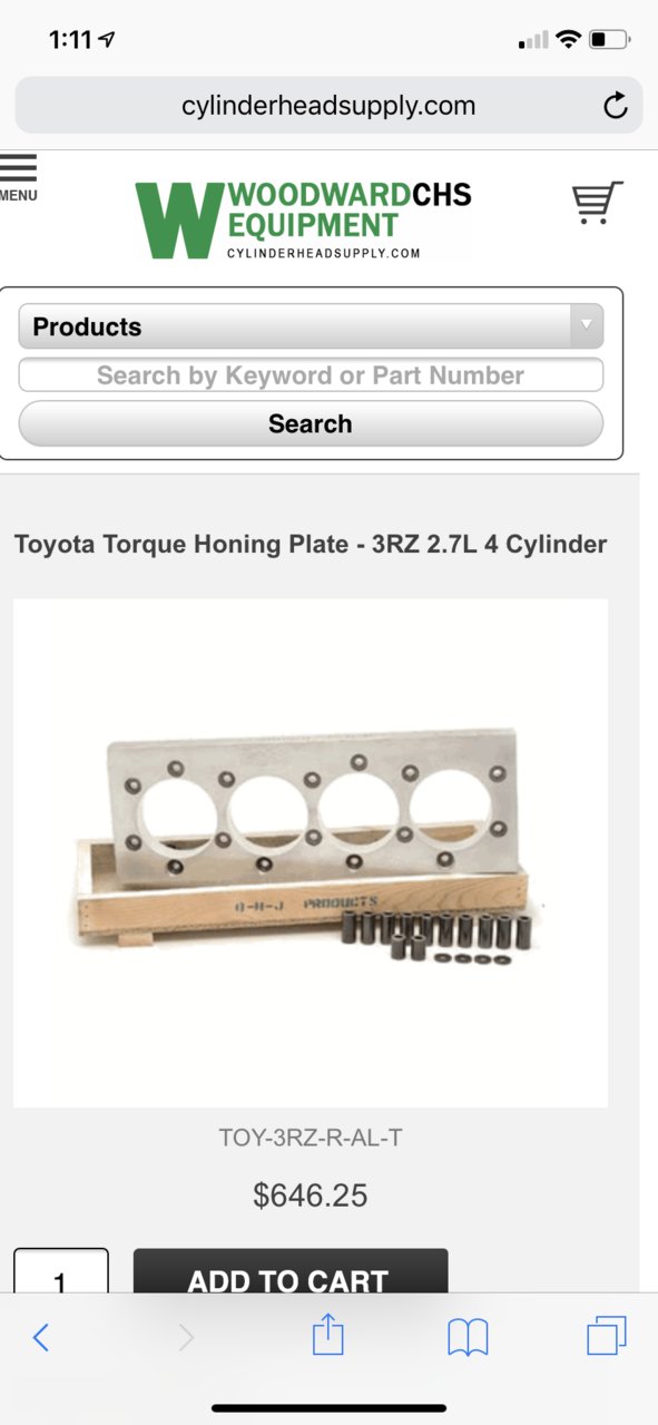

    Is this necessary for my built 3rz? Are there any cheaper options @Torspd E1949B51-D8F3-4038-9C52-DD1E8B5384B2.jpg

    For light honing, no. For boring, yes.
    LCE should have them as well. Not sure if for sale though. That'd require a call.

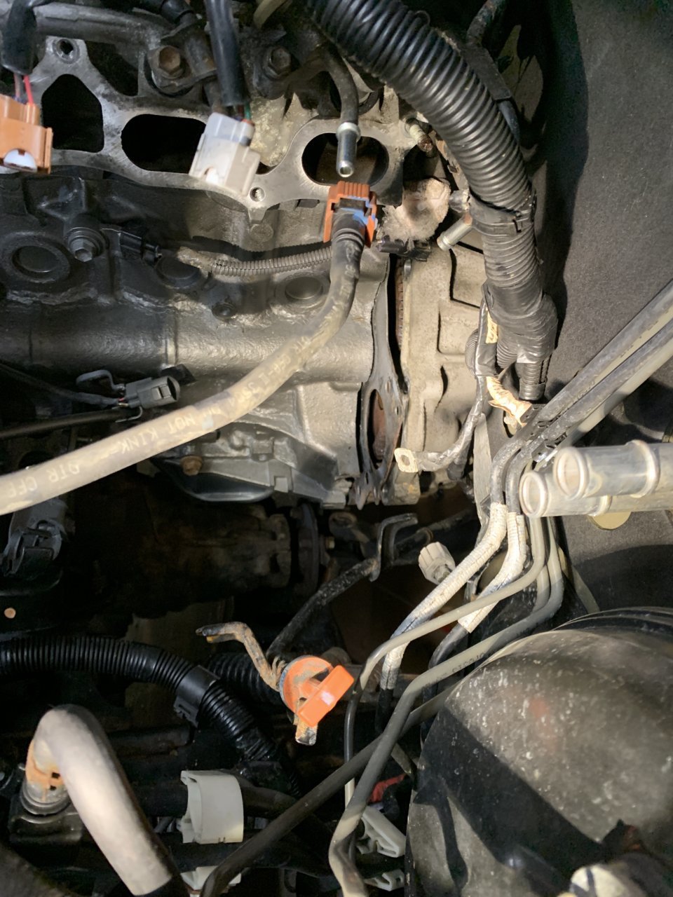

    @Torspd @Loxsl having a hell of a time closing this gap from new motor to the transmission. I pushed to torque converter on until i felt two clunks. I really jusy can’t seem to get it the rest of the way.

    Crisis averted I needed to reseat the torque converter... damn automatics

    I think you maybe short a clunk. Did you measure the setback?

    Yup. As soon as you said two clunks....good job @buyobuyo
