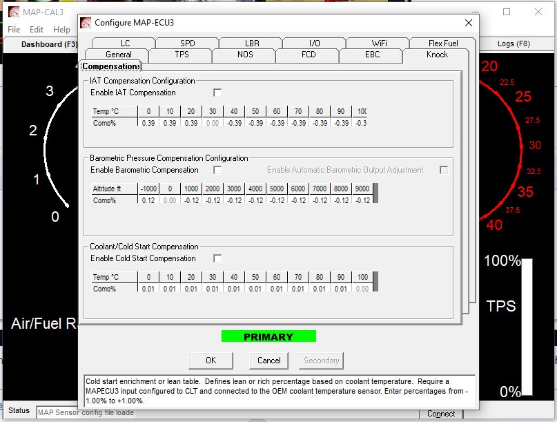

    Yeah the reason e85 hates the cold is because the colder alcohol gets the less it wants to vaporize its not a gelling issue, but after seeing videos of people adjusting their start up tune to enrich it I thought I might could get some insight from others that have used the mapecu3 on how to go about that without having 2 separate times. But after the timing was brought up I thought might be as good or better solution.

    There's a Cold Start Enrichment table in MAPCAL, but it's based on coolant temperature. To use it, you would need to tap an unused analog voltage input into the coolant temp signal to the ECU.

    Oh yeah that would be perfect; just like sub 50 an bam!
