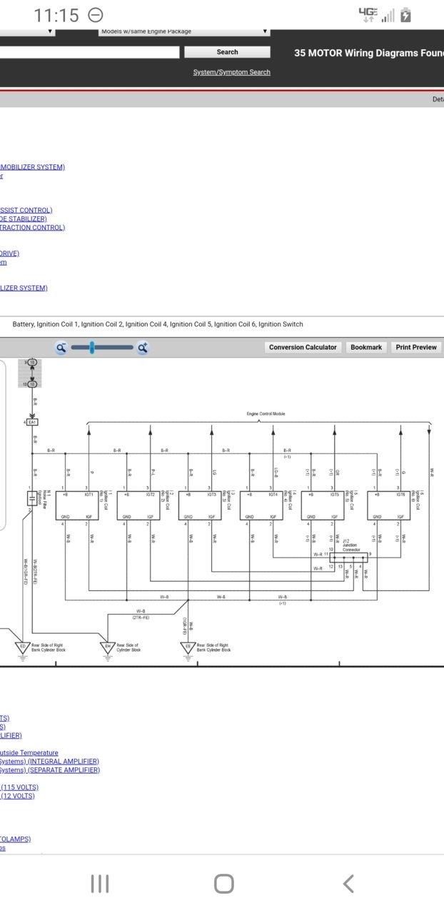

    The only other thing is that it ALWAYS throws the same cylinder misfire code, always being cylinder 1. So When I check the harness, I figured I'd trace all the wires from coil #1 to narrow it down. Process of elimination.

    Ohm test it and if you more then 5 ohms in the wire more then likely resistance is present. Check your grounds as well. I would hook in and do a continuity test and then shake the harness to see if you missed a frayed wire or a grounded out wire. We had this happen on some case tractors with the cam sensor. They wouldnt start found out the wiring harness from the factory was too short and they pulled it too tight to make it work. Vibration from the motor made it fray and ground out.

    So I'm coming up with needing to ohm out between the black/white wire and black/red wire?

    I would check for power first from b+. Verify you have battery voltage from the battery and reference it to the value from b+. Always reference from battery voltage. You should have minimum voltage drop if any. If you dont have battery voltage are a major drop it means it somewhere up the stream aka corroded wire, bad connector or bad connection. This is where you start checking ohms from where the wire starts to the coil. Make sure your ground lead is on the battery. From there verify your ground with the b+ and ground wire. Verify you have battery voltage. I cant pull up the resistance values on my software for the ohms, it wont work with android.

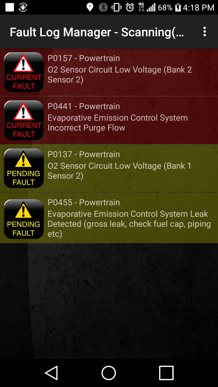

    A few questions:
    Should my ltft change this much (like a little, or a lot, different with each zone in the table basically)?
    Any ideas why there is such a discrepancy between the banks still?
    Also I had just cleared these codes thinking that might clear some of this up but if it helped it was barely noticeable (yes my fuel tank still has a small air leak somewhere so there's that)
    Oh on a positive note I had been getting a pending code that bank 2 o2 sensor 1 was stuck rich and I seem to have pulled enough fuel to drive on it 60 miles without getting that.

    I kinda have a similar problem with my O2 sensor (narrow band though). Only happened after adding the turbo. Basically every time I start the truck its pretty lean for about a minute until the sensor heats up. I believe this is caused by all the extra length of exhaust piping and the 3" down pipe. The exhaust gas isn't as hot or moving at a high enough velocity compared to a stock exhaust right out of the head. I'm hoping Ceramic coating all the hot parts will keep more heat inside and remedy the issue. It's not a big deal, but kinda annoying. After truck warms up it's fine and works great.
    In the short term, you could try heat wrapping the downpipe to see if that helps at all.

    That may be what is causing the code but shouldnt be the main issue because I cleared the codes while the engine was hot and the vid is with codes cleared... I replaced that o2 sensor last year thinking it was bad and it undoubtedly was not... Or I bought a bad one
