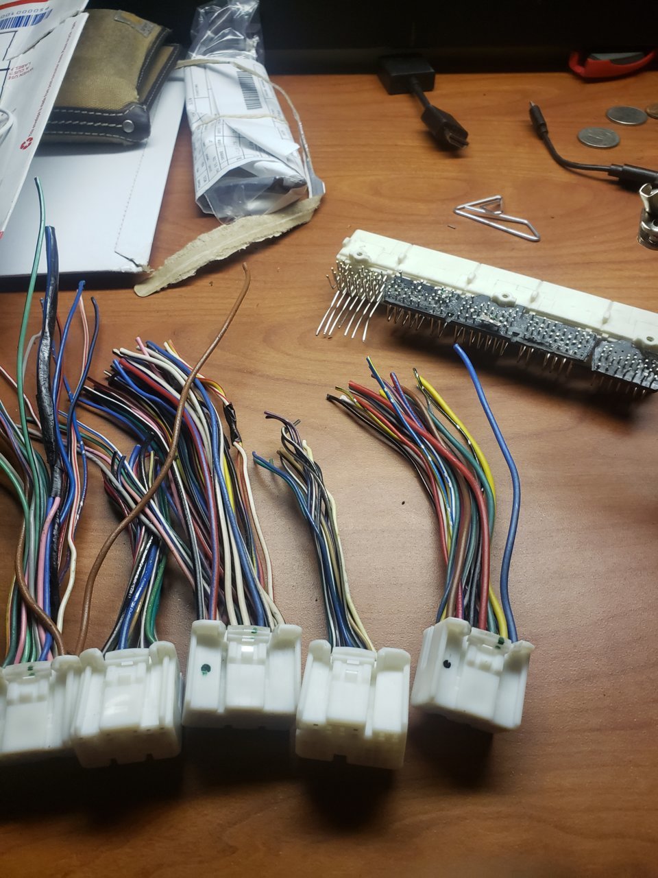

    Well lets not jump to conclusions lol i still have some codes i have to clean up. But it is running better. Im glad i ran that throttle body spacer and drilled and tapped it. Im getting a lot more accurate reading now. Im probably going to message you and a lot of other guys here about the map ecu

    Here we go

    Nice where you get that jumper cable?

    I went to the junkyard and paid 5 dollars for the male ends. My buddy had a 2007 highlander that was wrecked on his trailer he was parting out. He gave me the ecu cause i worked on his 6.0 powerstroke. I took the ecu apart and then cut off the solder points from the circuit board and bingo now i have the femal connector

    way cool. Have fun.
