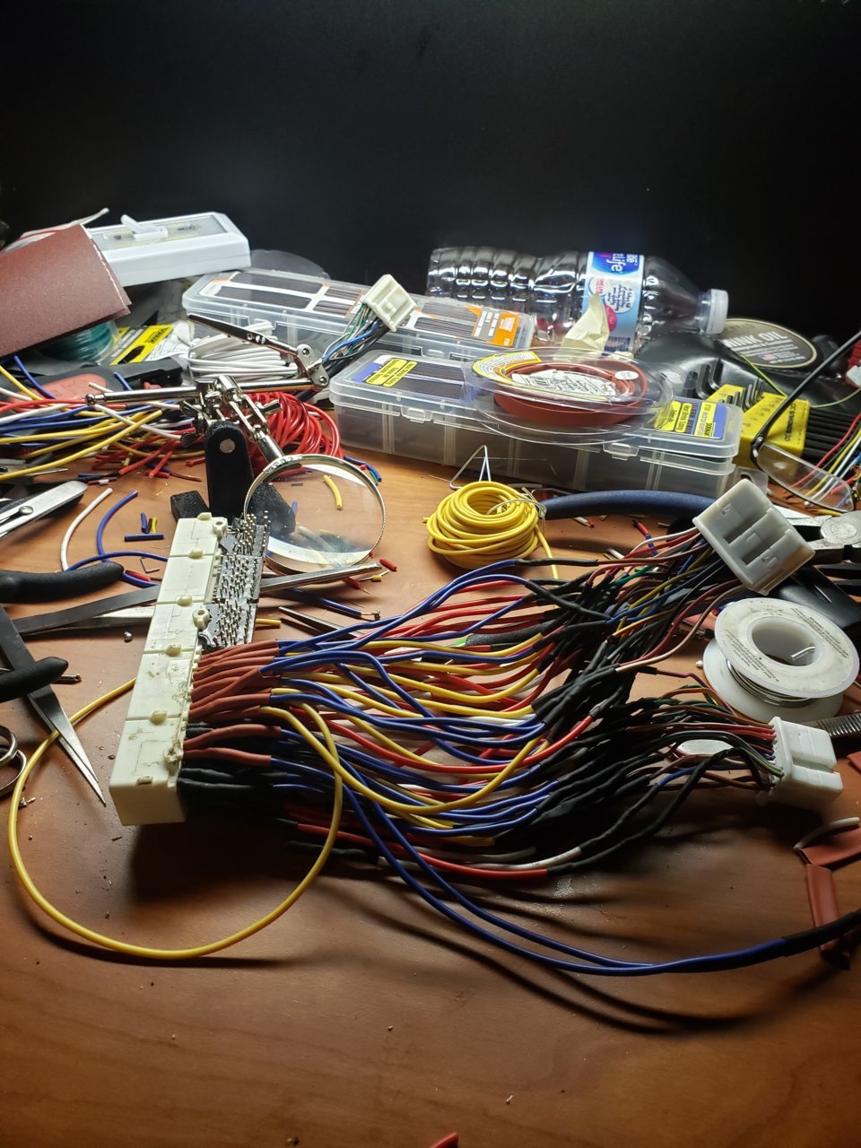

    Anybody on here get an afr calbrator for mapecu 3

    Yes and also @buyobuyo and probably also @MadTaco461

    If you're running the MAPECU3 on a 2nd gen, you have to use the AFR calibrator to make adjustments when the stock ECU is in closed loop.

    Sorry I just have o2 adjustment. I don't know how the afr adjust works.

    Thats what i figured due to needing to fool the ecu so your not fighting afr's with the computer
