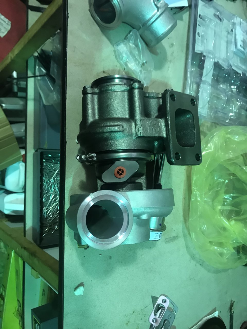

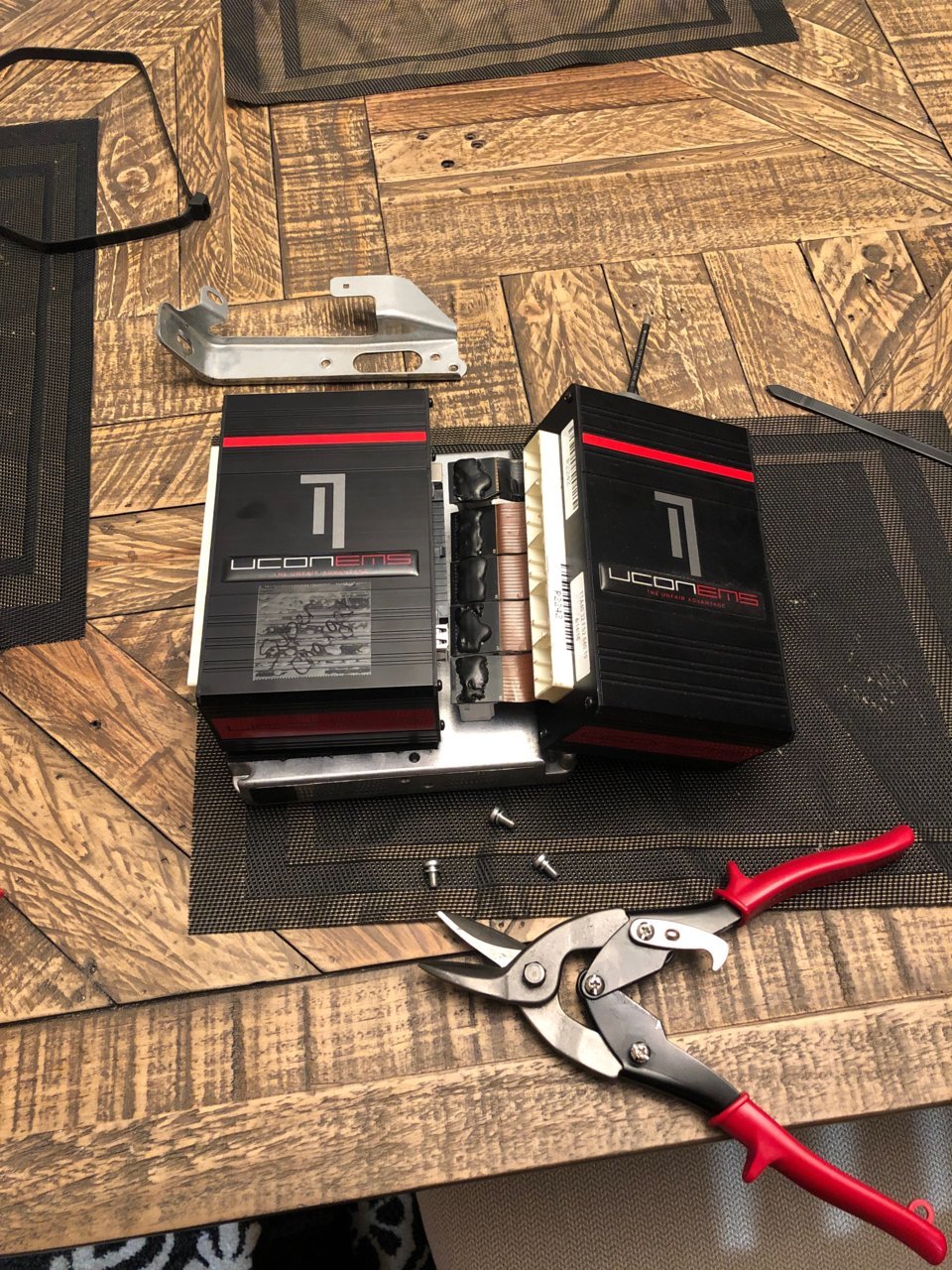

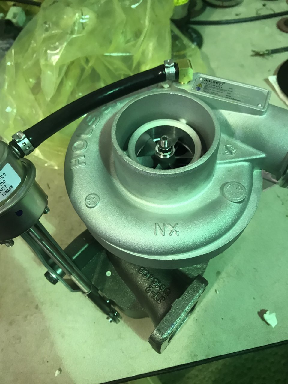

    I’m shooting for 300+ myself but not from a taco engine.
    Has a baby turbsky on her right now.
    44mm hx30w holset straight from Europe
    146AA774-08EE-4229-83EA-C9AA57BBC1DB.jpg CEABA0A5-9B37-4D12-9BFC-8F89C27C4074.jpg

    Nice, for the 4bt? Someone near my work has scout with probably a 4bt swap. Thing sounds cool. Has a pretty big turbo in it.

    Nice!!
    Yeah should have little to no lag, and after I get it all dialed in it’ll be getting compounded into an hx40 most likely.

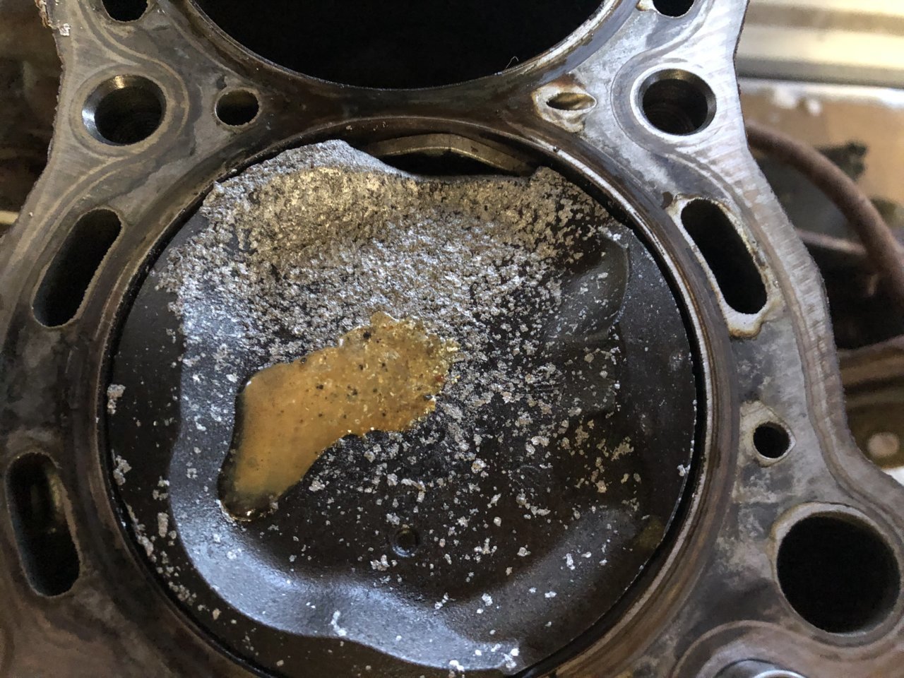

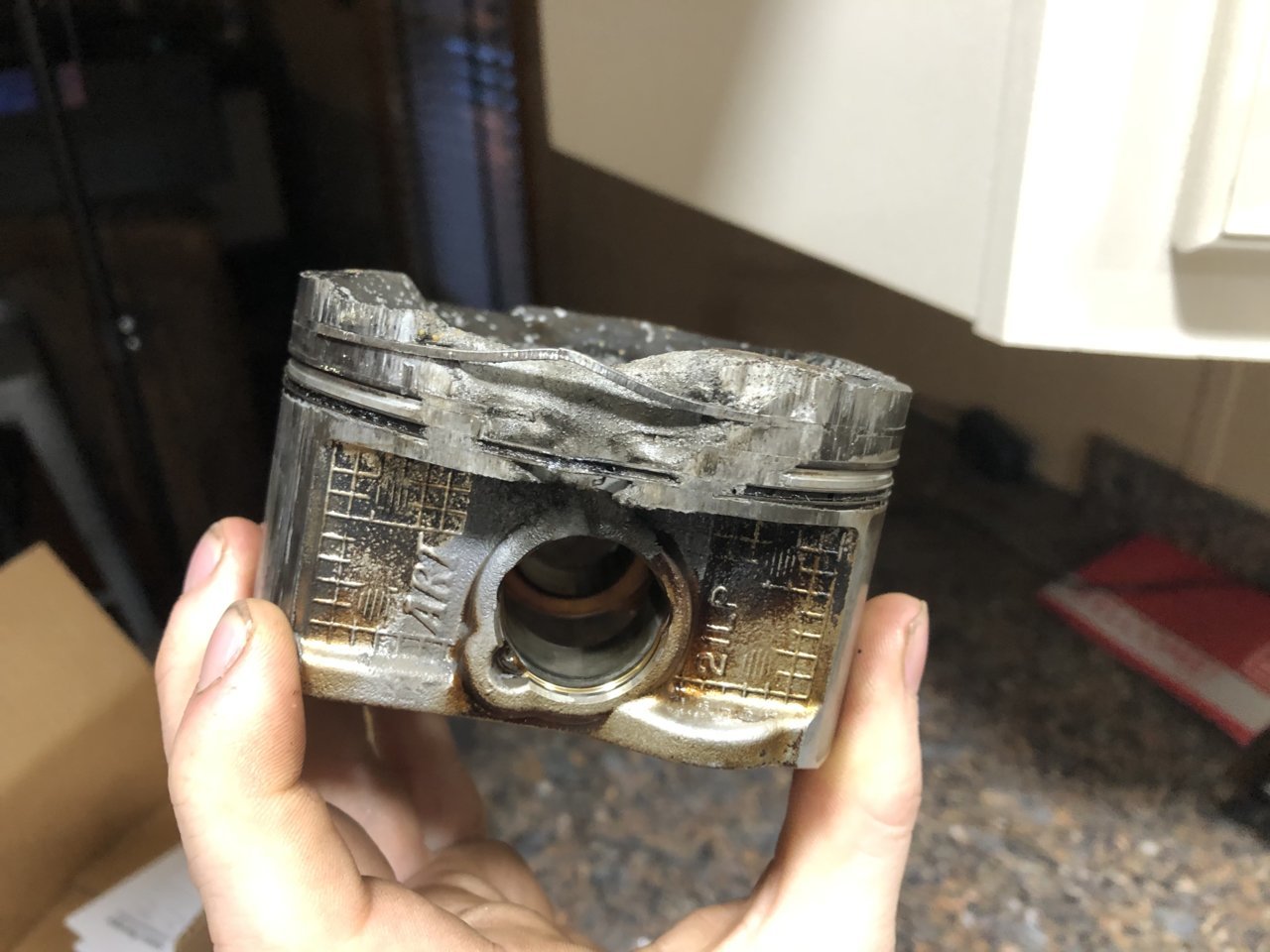

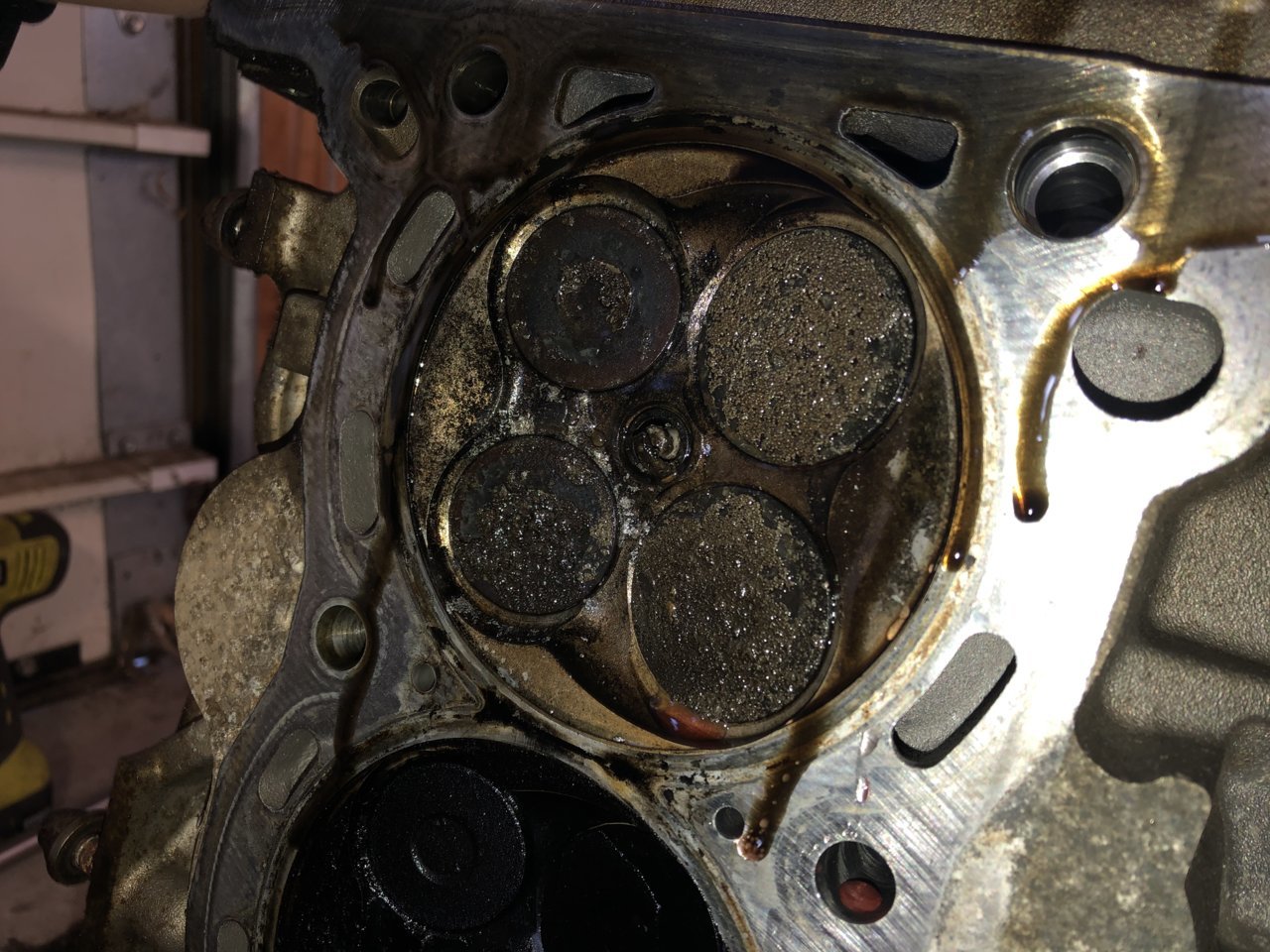

    Well I got into the teardown of my free spare engine today. Can't complain for the price since I knew it had zero compression in cylinder #1. Just hoping I can do a hone and new forged pistons all around instead of boring it bigger. 3175F4FD-73C1-4BDA-B3EE-6A24C8D7F070.jpg92082389-D98D-4C4D-9E72-EBDE21B991C6.jpg2D38BFE9-5172-43C7-BB76-8CF32EBF8BC8.jpg

    Hot dayum! That cylinder was hungry.
    Do like NASCAR, and just bore that one cylinder bigger. ;) For the sake of cleaning it up of course. :D

    Why not bore it bigger?

    I want to keep stock size on the bearings and pistons, I like the idea of more material being left for extra strength. Also cheaper cost and room for errors down the road.

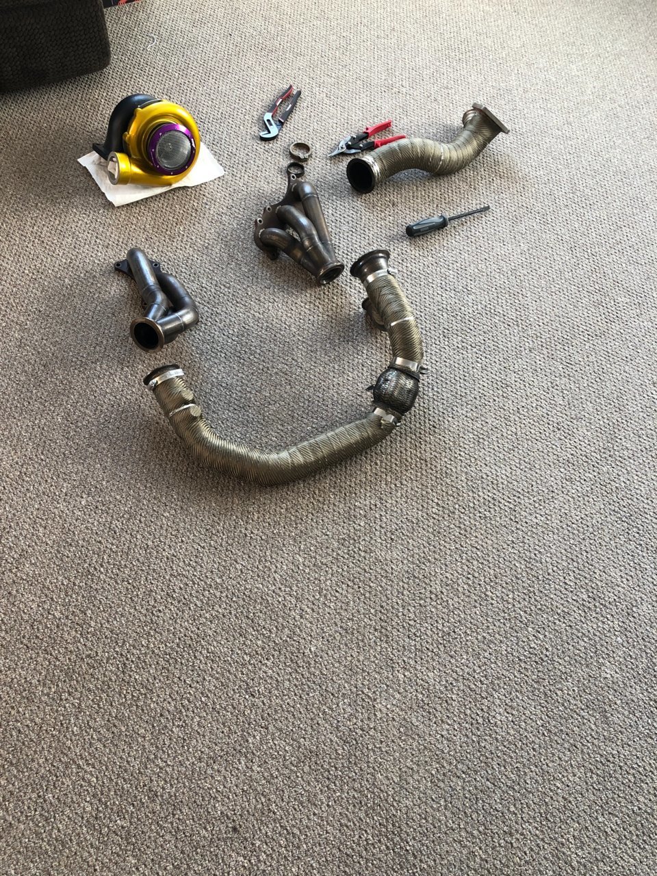

    so the guy I sold my turbo kit texted me and sent me this. He's got a new motor in his tacoma. He blew his other motor with the URD SC and the impeller shaft bent on him so he decided to install the Turbo kit with a new motor he got. He'll be rebuilding the fried motor that came out with the internals I had collected. He's pretty much carrying on my build that I had with my 2nd gen.

    Well a little sad, but also rewarding to hear that he is still moving forward and going bigger and stronger!

    yea its bitter sweet. happy for him though
